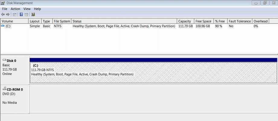

  9. joollyjohn jollyjohn's Avatar
    Mar 2005
    Sydney Australia
    Success.
    I did exactly as Nelson suggested and it happened. I never thought it would be that easy.
    Here is a pic of the disk manager:
    Thanks ones more, I'm still learning.
    John
