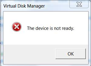

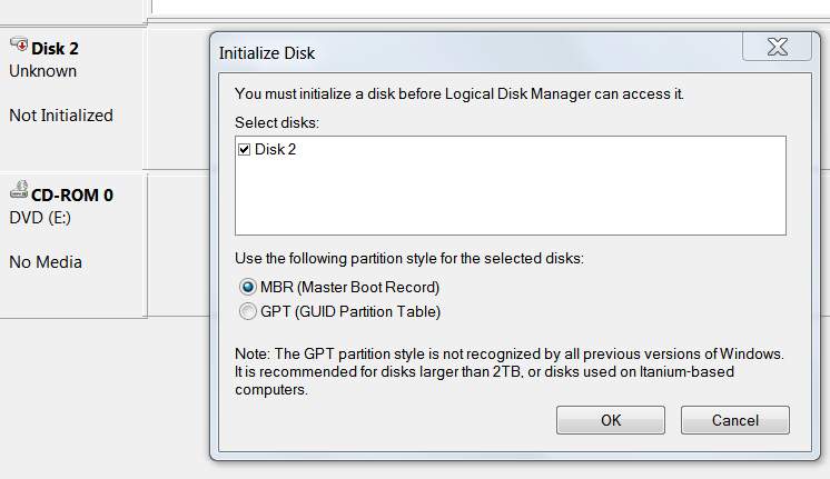

    I cannot initialize this HDD. I've tried different partition software programs. The message: The Device is not Ready.
    Any help is welcome and appreciated. (Windows 7)

    Have you tried windows disk management?
    Jan 2006
    Have you tried deleting the partition and recreating it? What size is the disk? The Note in your attachment says GPT is recommended for disks larger than 2TB, and you may want to try GPT if it's larger than that. I've had problems initializing disks in the past, and deleting the partition and then creating it anew has resolved the problem for 1TB and smaller drives.

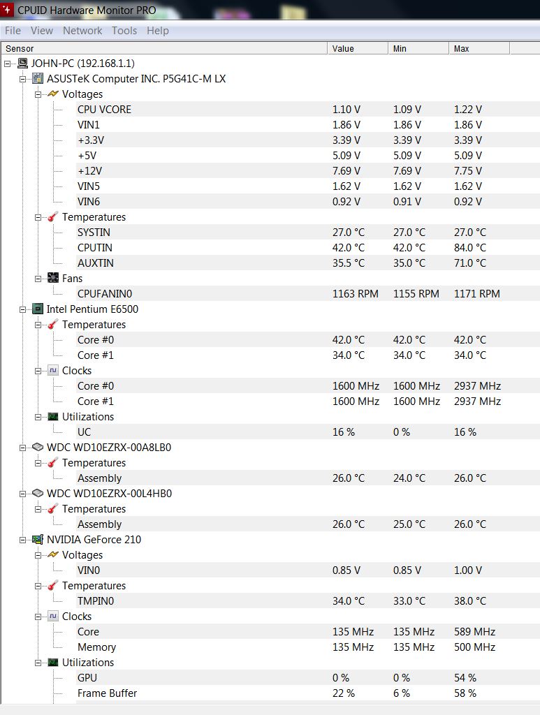

    @fritz93
    Your PSU may be underpowered either because of wattage or age. When I went past 6 internal HDs (currently running 9, including 1 SSD) on my 480 watt PSU, I would experience the same issues you're having. Switched to a 750 watt PSU and it's fine (*knock wood*). Note that the 480 watt PSU worked for a couple of years, but as it aged the errors started.
    Another possibility is what newpball stated about proprietary interfaces on external drives. There are reports of some WD 4TB externals not working when pulled from the case.

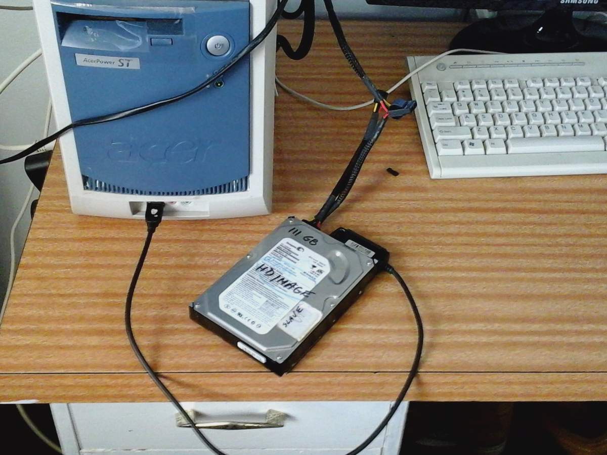

    The HDD an IDE interface and it is connected externally, It has an Acronis HDD image in it, not needed now. I wanted to save another image in there, but after checking the content and preparing to start imaging another drive the HD disappeared. I tried to enable it again but couldn’t. Even tried the CMD:

  15. That's a whole different world of possibilities. Usually, for those IDE to USB adaptors to work correctly, the drives usually need to be jumpered as "master". "Slave generally won't work, and "cable select" would possibly be the same". If the jumper is set to "master" though, or the drive defaults to master without a jumper, it should work......
    Also..... If there's rear USB ports try connecting the drive to one of them. They're usually attyached to the motherboard. I think maybe (I'm not really certain) a front USB port connected to an internal USB header can behave more like a USB hub.

  17. Something is broken. It's either the drive or the adapter, or possibly some strangeness happening to the drive on a low-level, depending on what software was being used to "prepare to image" another drive.
    Simplify and remove variables. Disconnect all internal drives except optical, connect drive internally (if interface available), boot from CD, delete and re-create partition, format. If no internal IDE, try to find an older PC, or continue USB connection but boot from an optical disk with internal drives dis-connected.
    I very strongly distrust and dislike USB drive connections as they are a frequent source of both complete failure and un-readable drives. They are, IMO, for temporary use only, not frequent use or primary storage. Do they work most of the time, sure, but their failure rate is far higher with much more limited usage time than internal drives, in my experience. If used as a primiary backup in business there MUST be more than one copy.
    That sounds very likely, thanks. I recalculated for PSU requirements, adding 20% capacitor aging and the calculator said 505 watts (with 30% aging, it said 543 watts). The PSU (a good quality bronze) is 3 years old and rated for 550 watts. Never had the slightest problem with it but that's a little close.
    So I just ordered a bronze Corsair (650 watts) from Newegg.
    Pull! Bang! Darn!

    Does the mother board have an IDE connector so you can bypass the USB conversion to see if that's the problem?

    Good call on replacing your PSU. You're defintely on the edge with your current PSU. Another issue I was having before the switch was that one or more drives would disappear upon reboot, then reappear after several restarts. Delaying the start-up of some of the drives (in the BIOS) helped sometimes. But again, swapping the PSU fixed the issue.

    Couple of other thoughts just came to mind.
    Try connecting your drive to a cable with only one or two molex connectors (wide 4 pin). If there are two connectors, use the one closed to the PSU. IDE drives can be really picky about the power they receive.
    Another possibility is an underpowered PSU. You're using a pre-built PC (which is fine), but manufacturers use the minimum required components. Like the problem I suspect fritzi93 is having, there's just not enough power to run your additional drive.

    If that image is how its currently connected your better off setting the ide drive to master or slave ... both work ... and physically connecting it to an internal ide cable. If that pc has an ide optical drive simply swap the drives over (master is end of ide cable, slave is middle connector) and try again to initialise drive.
    This is the only method that works where issues occur when connecting drives any other way... it reduces interfaces which may not be fully compliant and or faulty.
    Do this before tossing the drive.
    Thanks mate.
    I'll try that and if it didn't work here I'll have a go on an older PC that's all IDE.
