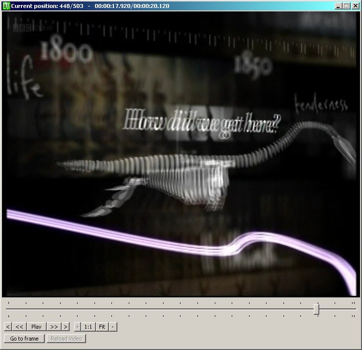

    Thanks, here's some examples. (I hope they are suitable).
    They are the taken from the intro of Episode 1 and 2 of a programme, both of which were burnt to the same DVD.
    Episode 1 is fine, episode 2 shows interlacing artifacts. I can't remeber if they were in HD or not, however other HD recordings don't exhibit the same issues.
    I also plan on changing the widescreen flag on the files, as I have an issue there too.

    The first VOB is progressive video encoded as interlaced. The interlaced fields are duplicates.
    The second VOB is progressive video encoded as interlaced, but the duplicate "interlaced" fields are out of sync.

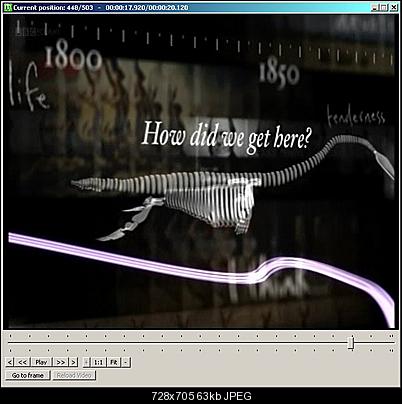

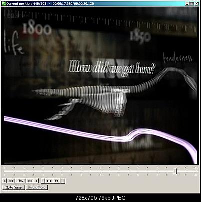

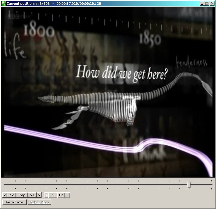

  10. Simple field matching seems to do the trick, then you'd encode it as progressive. I don't think you can do it with Handbrake, so you'll probably need to use an Avisynth based GUI for re-encoding. If you've never used Avisynth this probably won't mean much to you, but after adding field matching to the script
    TFM()
    your second example goes from this:
    To this:
    You shouldn't need to de-interlace. Just match the fields up.

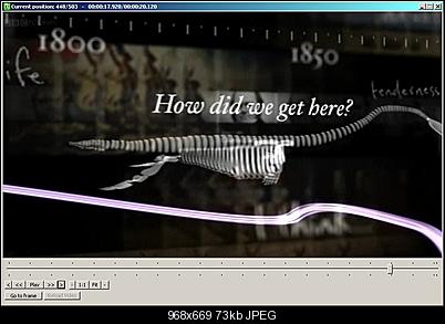

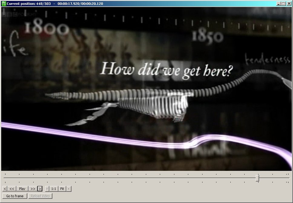

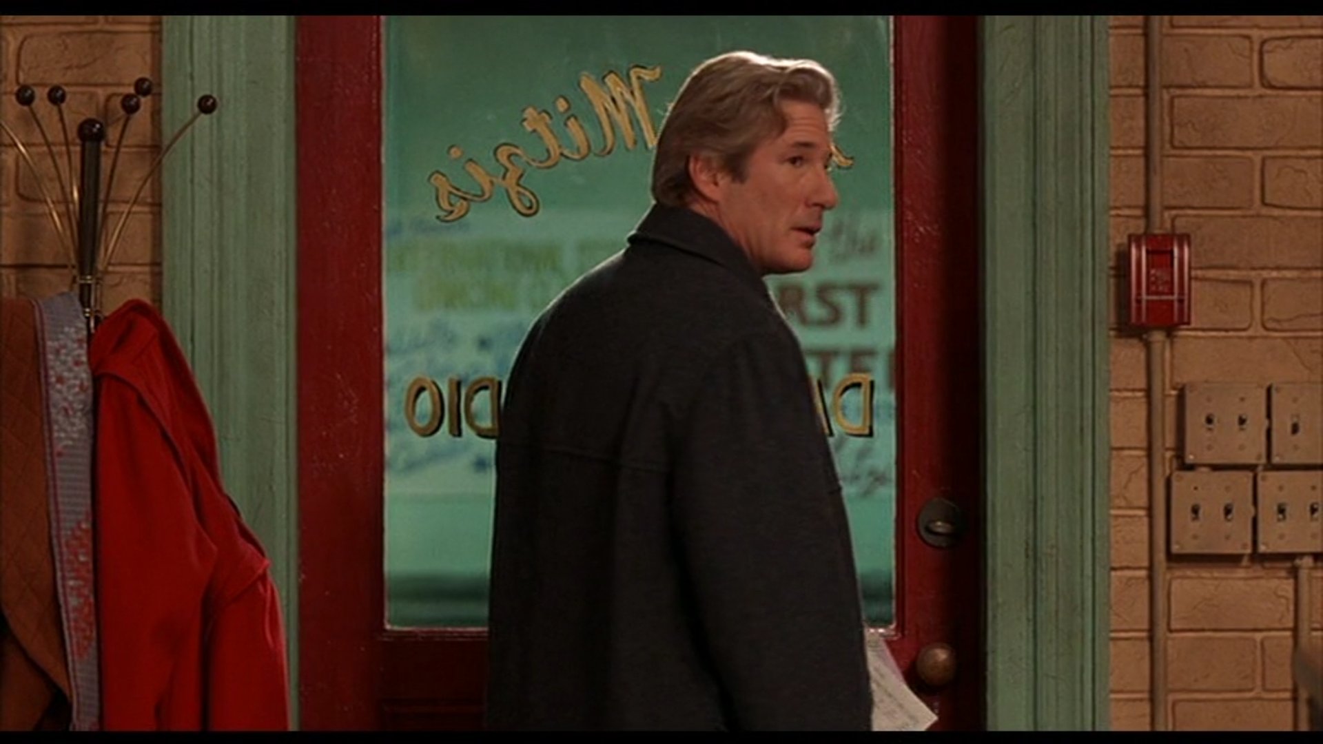

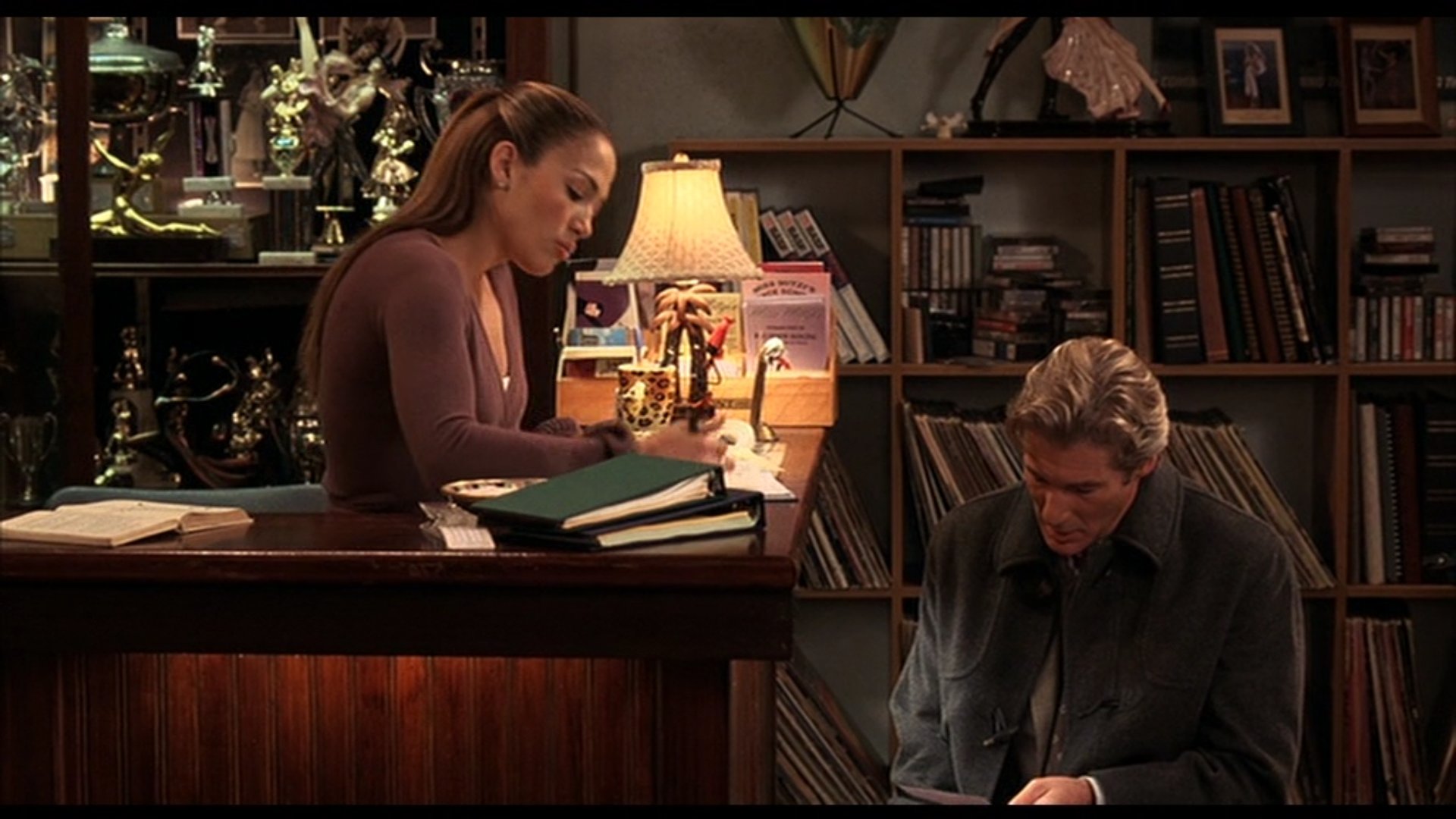

    That's the sample displaying in MeGUI's preview. I didn't worry about aspect ratio issues so it's not resized correctly.
    Although if I did resize I'd probably crop a few extra pixels from the sides and resize to exactly 16:9 dimensions for encoding. In this case 14 pixels left and 14 right and 4 pixels top and bottom to remove the black, then resized to 960x540 (or any 16:9 dimensions).

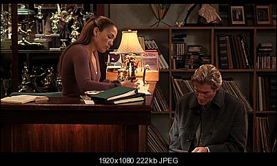

  11. Composite or s-video signals are always interlaced in the sense that fields are transmitted one at a time (never entire frames). Both videos are interlaced in the sense that the MPEG encoder treated them as interlaced video and encoded them top field first. And the actual source is progressive (probably film) for both. In the first video pairs of fields from the same film frame are paired together so the frames look progressive. In the second video pairs of fields from different frames were paired together so the frames look interlaced whenever there is motion. Ie, the first video was broadcast top field first and capture top field first. The second video was broadcast bottom field first (for some unknown reason) and captured top field first. Both will play properly when using a player that deinterlaces for display. The second video can be "fixed" by re-pairing the fields properly. As hello_hello indicated, you can use TFM() in AvisSynth. Or, if you know the entire video is this way you can use SeparateFields().Trim(1,0),Weave().

    I did this 3 different ways. But TFM() was simplest. First I made a .d2v project file with DGIndex, then used this script (adjust the path statement for the video's location):
    MPEG2Source("drive:\path\to\video\VTS_01_1.d2v")
    TFM()
    The re-encoded result is attached. I used a slightly higher bitrate to re-encode and remixed the audio later. Sorry, my h264 encoders aren't on the PC I'm using at the moment. Encoded as progressive. Only question now is, what the does the rest of the broadcast look like?

    Oh, and the video is being seen as 4:3. I assume it's 16:9 so when the script creator opens the first thing you should do is change the Input DAR to "ITU 16:9 PAL" so then when you apply cropping and resizing MeGUI's aspect ratio error calculations will be correct.
    Also, and I wish it was the default because I'm so sick of typing instructions, if you want to resize the video "up" (ie 1024x576 or 960x540 etc) instead of resizing "down" (720x404 or 640x360 etc) you need to enable "upsizing" in the script creator's Avisynth profile configuration. It's monumentally retarded that resizing a PAL 16:9 720x576 DVD to 1024x576 square pixels for the correct aspect ratio is considered upscaling, and even more retarded that the option is disabled by default and hidden away in the script creator's profile configuration, but the MeGUI developer thinks it's a good idea for some reason. Of course if you use anamorphic encoding instead of resizing to square pixels none of that probably matters.

    It's monumentally retarded that resizing a PAL 16:9 720x576 DVD to 1024x576 square pixels for the correct aspect ratio is considered upscaling,...
    It really is not.
    In simple terms, PAL has not enough bandwidth to render 1024 discrete values for each discrete line.
    When you go from 720 (or 704) to 1024 you really do upscale!
    By the way a horizontal resolution of 720 lines (or 704 which is more common) may be kind of stretching it already. But "stretching" things is common in the industry, makes it look better.

    I'm not one for upscaling SD video. Always looks kinda goofy, if not soft. Anyway, I boo-boo'd and posted 4:3 earlier. You can't go BluRay with 720x576 progressive, but mkv can take advantage of high BluRay-style h264 bitrates for progressive SD 720x576. So, attached is a rework at 16:9 DAR.

  23. Originally Posted by newpball View Post
    "It's not true, it's not true, newpball is wrong, he is wrong" (repeat 1000 times).
    It's nothing to do with bandwidth. Open a PAL 16:9 DVD with pretty much any software player and count the number of pixels on your PC monitor that are being used to display it at the correct aspect ratio. If it's something like 1024x576, then how can encoding it at 1024x576 be upscaling? You could argue the storage aspect ratio is being upscaled, but not the display aspect ratio. You'd be the first to interrupt a thread and fill it with chicken little predictions if someone suggested encoding it while reducing the height because that would be downscaling. Or are you going to argue that as long as the width exceeds 720 it's not?
    There's an obvious line between what's considered upscaling and what isn't when it comes to sources with square pixels, but when the source is anamorphic the position of that line is less clear and in my opinion it should be where the resolution of the height starts to increase for anamorphic 16:9.
    You tell people to resize to 1024x576 because it retains the most detail. Sometimes I think you just like to contradict to cause arguments. Resizing that way should be considered resizing, not upscaling, and MeGUI should be able to distinguish between the two, in my opinion.

    I don't understand the "soft" remark. I find, at least when using a sharp resizer such as spline36, a PAL DVD resized to 1024x576 and re-encoded that way tends to look a tad sharper than a 720x576 anamorphic encode. In fact most of the time, even resizing to 960x540 and running that fullscreen will tend to look a bit sharper than the original video.
    Here's some comparison screenshots from some comparison encodes I made when first deciding whether to switch to square pixel encoding. Both are running in MPC-HC fullscreen at 1080p so they're both being upscaled the same way. The difference is the first is being upscaled from 720x576 while the second was resized to 1024x576 first.
    The attached sample (a re-encode of Grumpycat's second sample) was resized to 1048x576 for easy comparison. Normally I'd crop and resize to exactly 16:9. I can't really pick the difference between it and the anamorphic encode when they're both running fullscreen.

  24. Here's the samples from which the previous screenshots were taken. No other filtering was applied as I recall. Unless I applied the same filtering to both (ie same noise removal) but I doubt it as that wasn't the purpose of the excercise. I encoded these a fair while ago though. January 2014 according to the file dates.

    Originally Posted by Grumpycat View Post
    HandBrake's decomb filter does IVTC (I'm fairly sure), and then it's supposed to de-interlace any residual combing, so logically it's got to do field matching. You could try enabling the decomb filter while telling Handbrake to output a constant frame rate of 25fps. I don't know whether that'll get Handbrake to do field matching or if it'll just try to de-interlace. If it's the latter the de-interlacing will probably cause blurring so that's not ideal. You can only try though. I don't use Handbrake myself so I'm not sure how it's filters work exactly. If not, Avisynth is the better method anyway as it gives you more control, once you've learned a bit about using it.
    Thanks, I'll give it a try. I have also downloaded Avisynth, but it looks a bit daunting! I'll have to do some reading up before using it.
    Thanks again for your help.
    Edit: I see LMotlow has posted alternative instructions for doing it all the same way, only differently (no GUI vs GUI). Either way.......
    The only thing I'd add is he mentions Avisynth installs in a folder called Avisynth 2.5 even if you install version 2.6. That's no longer true. The very latest 2.6 release candidate (RC3, I think) now installs in a folder simply called Avisynth. It's only been out a few weeks. If you've installed an earlier version, uninstall it before installing the latest 2.6, let it delete the registry entries/plugin folder location and delete the Avisynth 2.5 folder yourself when it's finished if you need to before installing the new version.
    According to manono, Handbrake isn't the way to go, so try MeGUI. There's quite a few Avisynth based encoder GUIs. The object of the exercise is generally for the GUI to let you crop and resize and/or apply de-interlacing etc in the usual manner, and the GUI creates the script required for encoding. Aside from MeGUI (which is the one I use), StaxRip, RipBot & Hybrid are other Avisynth based GUI's that come to mind. If you want to modify the scripts manually, you want a GUI that makes it easy for you. I think all the GUI's I mentioned will let you do that, I just prefer MeGUI.
    Open the first vob file in the set using the File/Open menu and MeGUI should offer to index it and extract the audio. Add the indexing job to the queue and run it. When it's done the script creator will open with a preview for you to crop, resize and apply filtering. To apply TFM() you could enable de-interlacing, select "film" as the source type and "IVTC" as the de-interlacing method. When you switch to the Script tab you'll see a couple of lines like this:
    LoadPlugin("C:\Program Files\MeGUI\tools\avisynth_plugin\TIVTC.dll")
    tfm(order=-1).tdecimate()
    That's MeGUI loading the required plugin and applying IVTC. The tfm() part does the field matching and the tdecimate part would then remove the duplicate frame (for IVTCing NTSC to 23.976fps). In your case, all you want is the field matching part, so you'd delete .tdecimate()
    tfm(order=-1)
    Make it the last thing you do before saving the script because MeGUI re-writes the script any time you change something in the script creator GUI so manual changes will be lost. You can use the preview button before saving though to see the result in the video preview.
    That should get you started. You don't need Avisynth installed because MeGUI uses it's own portable version but it's still a good idea as then you can open scripts and encode/preview them using other programs. I use MPC-HC for previewing scripts running on my TV before I encode them. If you've installed Avisynth, hopefully you've installed the latest version 2.6 release candidate. Version 2.5.8 is the last official stable version but it's outdated.
