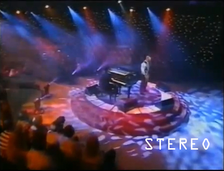

  1. I'm using my old Sony SLV X811 video cassette recorder for shifting VHS tapes to DVD. I'm recording them at highest recording mode XP into my Pioneer 550HXS hard drive recorder.
    However during the transfer, if the video cassette has a slight tracking issue, the sony VCR flashes "STEREO" on top of the picture, which means it contaminates the video transfer.
    I have long lost the manual for the Sony VCR, and any info to this machine seems to be pretty thin on the ground when googling.
    Does anyone know how either by the machine, or the remote, how to turn this "STEREO" visual warning off?

    If it is not in the VCR's menu then the option of turning it off does not exist. Sometimes manually choosing an audio option(if that exists on that machine) instead of "AUTO" or "AUTOMATIC" does the trick.
  3. Thanks, the closest thing I found on the remote, was located on the upper left side, a button labelled "display". It will show an imprint of the timer clock on top of the video when it is on. Hitting the button just alternatively turns that clock on or off, but you're most probably right, can't turn off that annoying "STEREO" imprint. It seems to pop up for around five seconds, and comes about every 20 to 30 minutes, whenever they maybe a crease in the tape that may throw the tracking off. 90% of my tapes are in mint condition, I've meticulously wound them through and kept them all wounded back.

    Long Shot: Not familiar with that model, but I seem to remember some decks (usually pro decks) used to have 2 types of output - a CLEAN output (usually just labelled "out" or similar) and an output that included on-screen display (usually labelled "monitor" or similar). If yours is like this, perhaps swapping the connections would work.
