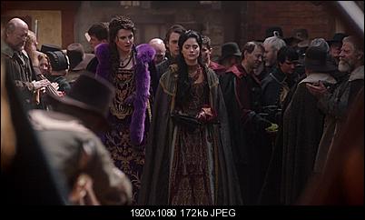

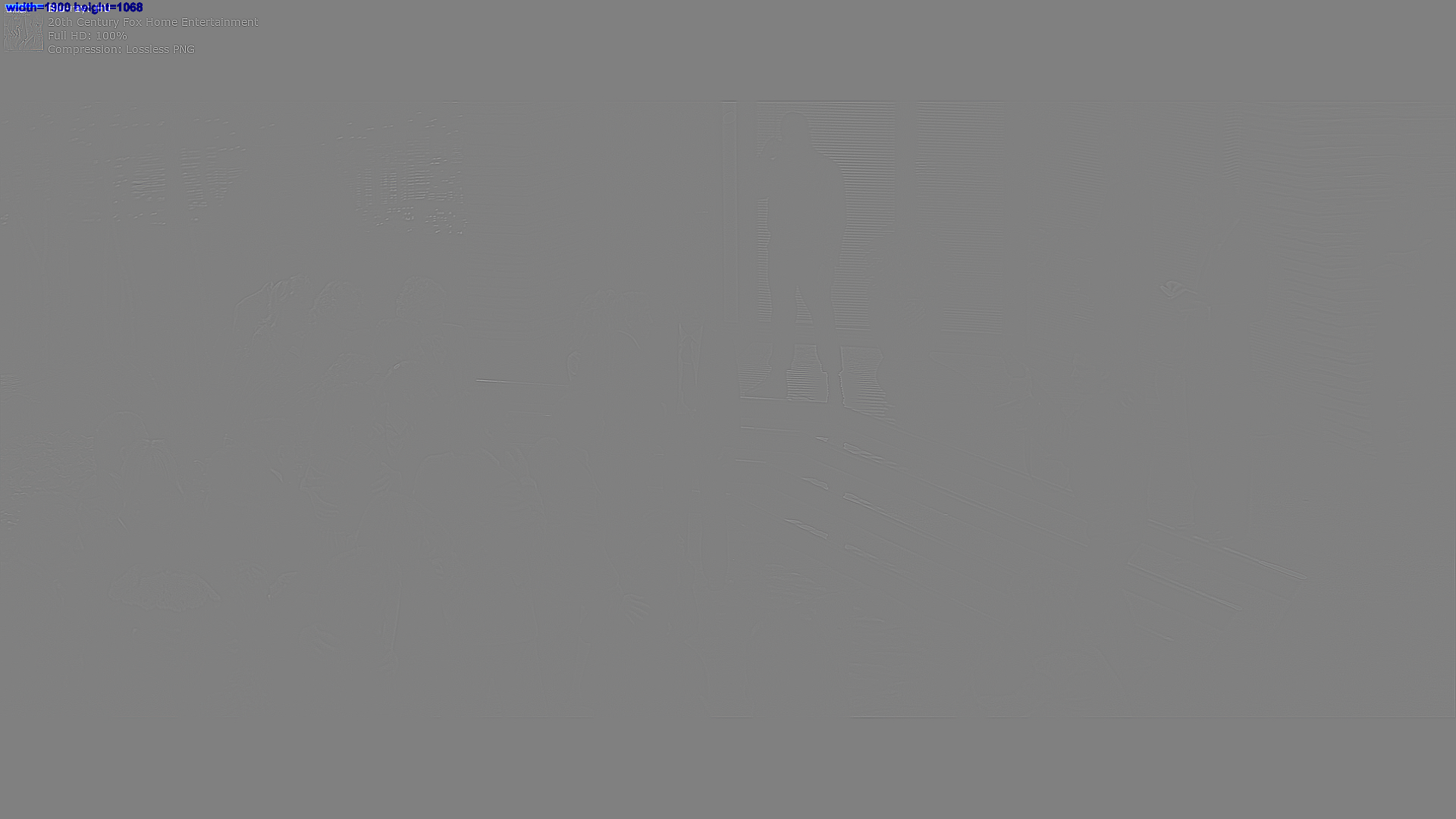

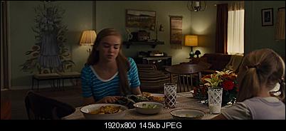

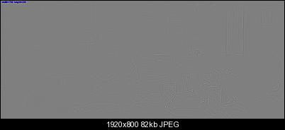

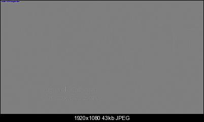

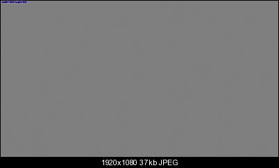

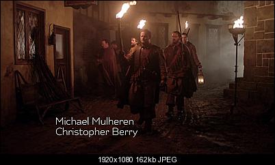

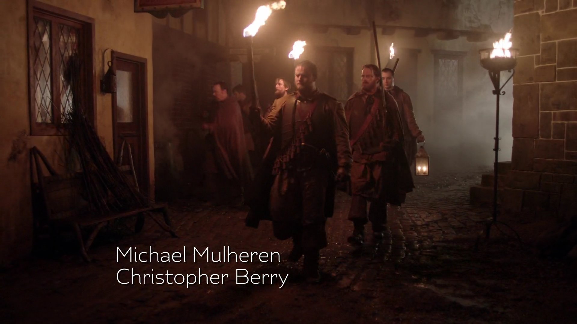

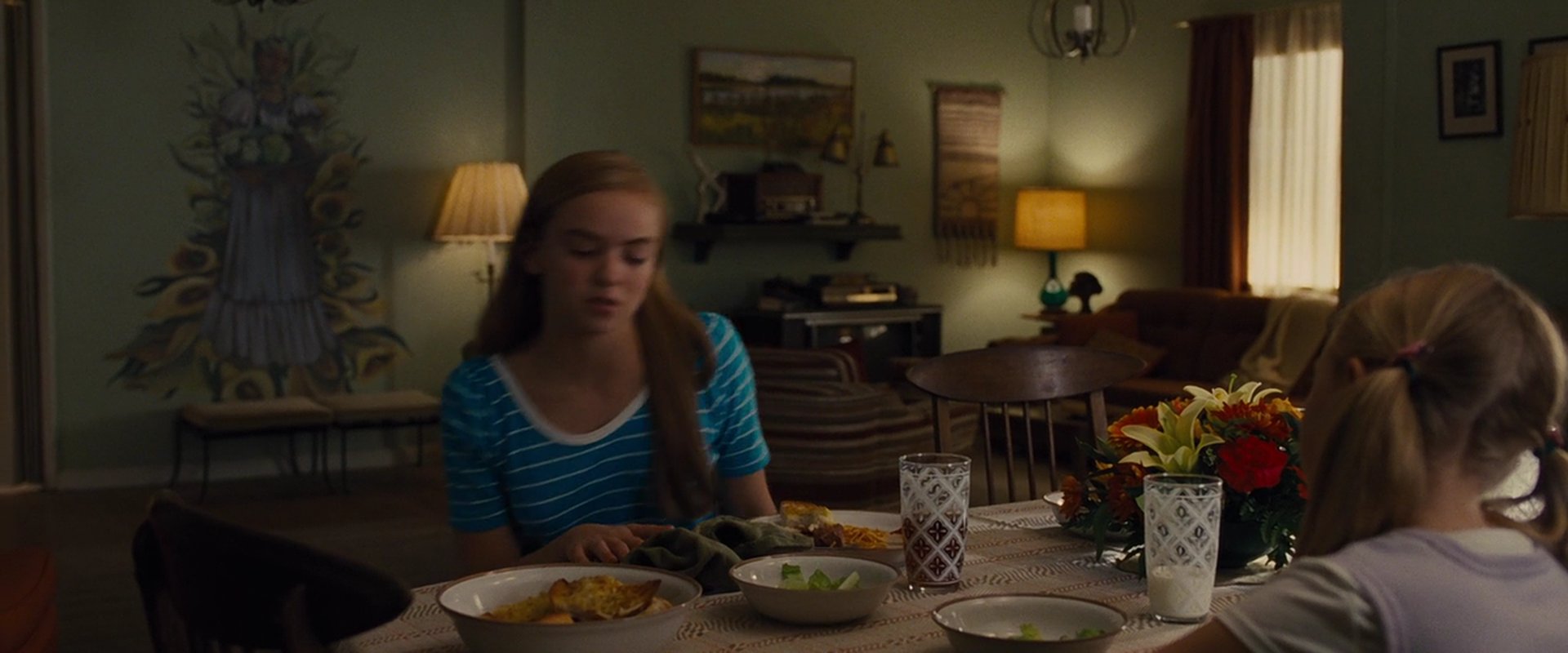

  2. I gave it a spin but I still can't get my head around whether it's an effective way to determine resolution in respect to picture detail. Especially as when I tried a section where there were opening credits, the credits appeared to have more picture detail than the picture itself.
    To me it's showing differences in brightness more than resolution. And even then I'm not completely sure if that's what I'm seeing. Am I looking at this the right way?
    Edit: Damn! I think for the second pair of pics I was off by a frame so they're not the same, but they're probably only off by one so it doesn't change anything in respect to picture detail.

  3. Titles are often computer generated and overlaid in post. So they are often sharper than the underlying video.

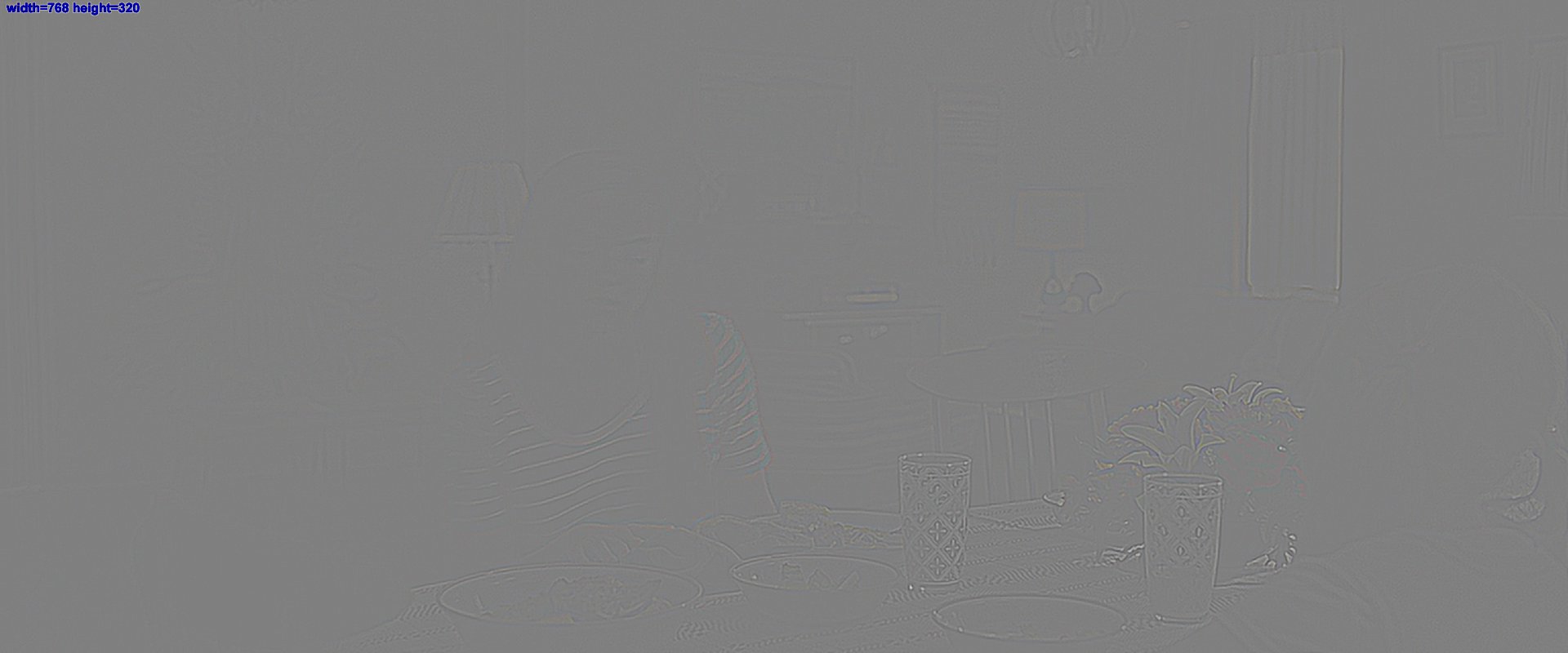

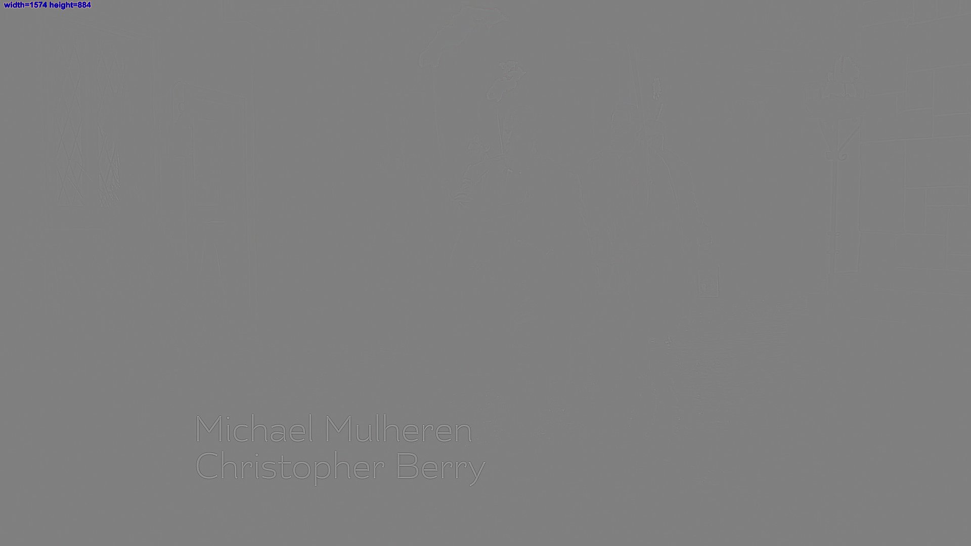

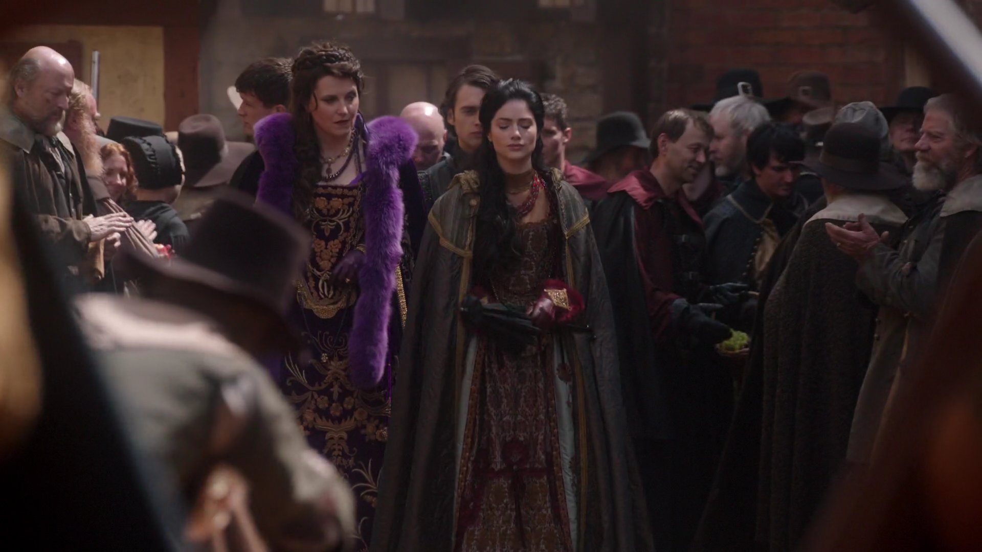

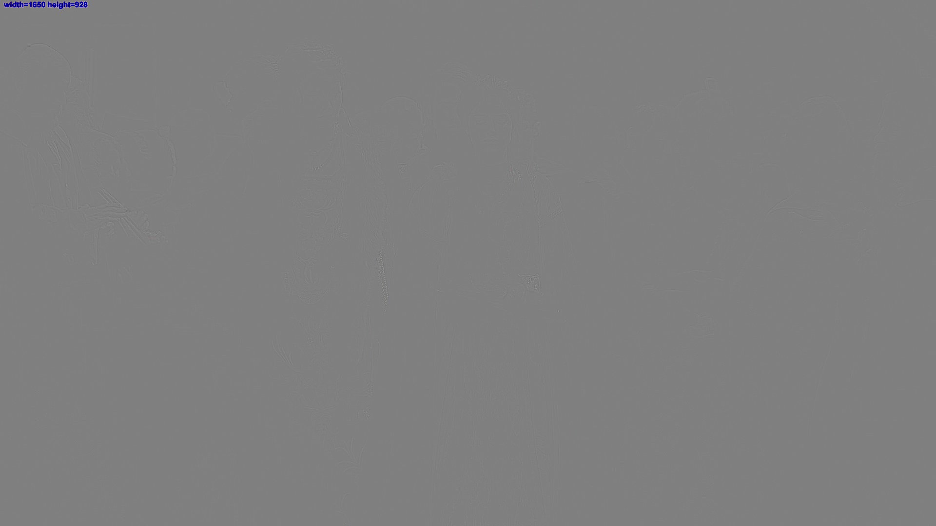

  9. I tried again, and at the moment I'm pretty sold on the "downscale, subtracting the original" method for determining picture detail not being a particularly good one. Not unless there's a resizing method that makes it work. I'll confess I cheated a little with this one as it started as 720p and I resized it to 1080p so I could apply jagabo's script without changing it, but the picture is a little noisy. It's probably digital but in this case there's a scene with enough fine noise that I can see it on my TV from three or four feet away.
    Couldn't noise, especially if it's fine noise, be looked at as the ultimate in fine picture detail, even if it's unwanted picture detail, so if the "downscale, subtracting the original" method of determining picture detail worked, shouldn't fine noise reveal itself pretty early? It didn't here. I'm down to 768x320 and there's really not much noise showing, yet in the original video the pattern of noise on the wall can easily be seen.
    Am I not looking at this the correct way?
  10. I see quite a lot of differences in your subtracted image. Noise is low amplitude so it won't show up really well after a subtraction. You can increase the contrast to make the differences more visible. Applying a sharpen filter will increase small detail and noise. Using a sharper resizing filter will also enhance noise and fine detail. Use ColorYUV(analyze=true) to show min/max Y numerically (you'll have to remove the subtitle). Instead of subtracting use interleave and compare the two images directly.
  11. Yeah I think I'll go back to comparing with my eyes.
    There's lots of differences in the subtracted image, but being a form of fine detail, I sort of thought noise should be one of the first things you would see. The fact that it's one of the last things to show up seems to indicate the subtraction method doesn't really tell you much about the amount of picture detail. Or maybe my theory there is a load of bullocks?
  12. Another thing you can try to accentuate low amplitude differences is Histogram("luma").

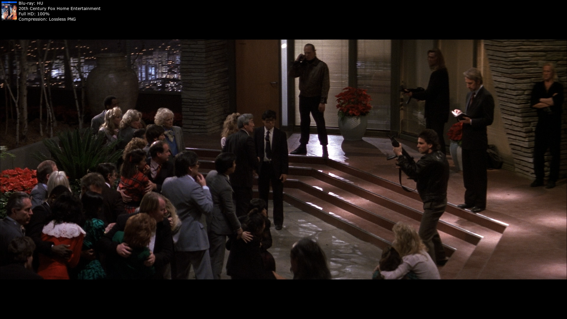

Name:	Die Hard - Caps-a-Holic.png
    Using a sharper resizer makes a big difference, but the finest lines are gone either way.
Name:	Die Hard - Caps-a-Holic - 1900x1068.png
ID:	31823 Click image for larger version
Name:	Die Hard - Caps-a-Holic - 1900x1068 subtract.png
