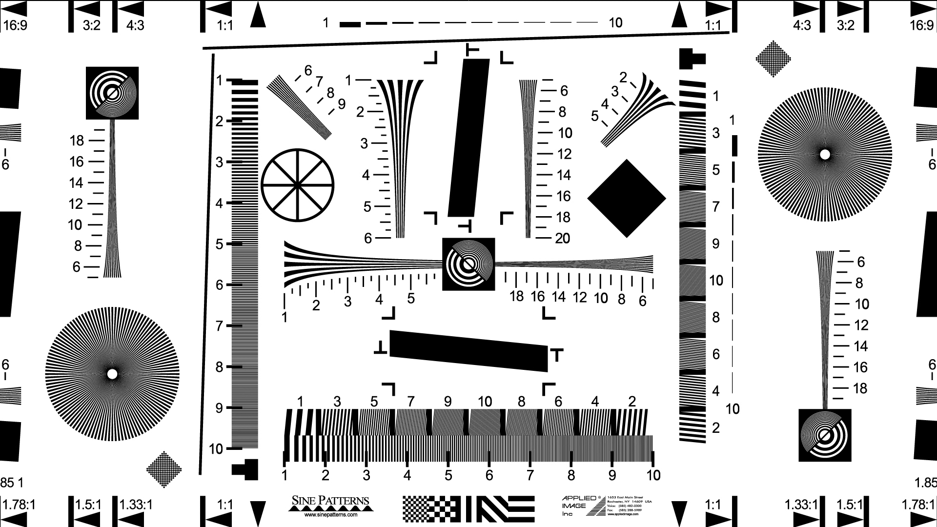

    Pattern 2 is aliased as hell. That isn't what a proper resolution pattern on Blu-ray looks like, Stears555.

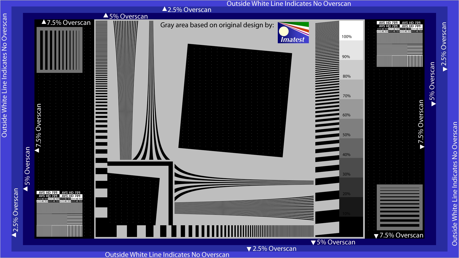

    AVS HD 709 overscan test with little lines and dots:

    I already posted an image that disproves your statement. AVS HD 709's overscan pattern (among others) includes alternating single-pixel grey and black dots.

    No, the visible resolution for a monochrome image really is 1,920 pixels across and 1,080 pixels down. It's obvious if you view a full-frame single-pixel checkerboard pattern, and should be obvious by inference from the smaller grid shown in the overscan test above.
    Are you saying AVS HD 709 isn't a "real" Blu-ray Disc? Why?
    We already mentioned the resolution of the chroma channels. I refer you to a colorless grid and you respond that color subsampling reduces the resolution of it. Do you see the problem here?
    In real images, compression reduces the visible resolution, yes. Not in properly-encoded static test patterns.

    I wasn't talking about those areas of the image. Look at the box where the text "AVS HD 709" is.

  25. Here's a better quality resolution test pattern. Note that the numeric labels don't directly translate to # of lines per width/height of the image. Around 11 corresponds to 1920x1080. The original image was a ~4K JPG, pretty clean, and was already cropped. I included the small text and discreet line patterns from Vapereon's image as an inset near the top center. The second half of the video has the same pattern reduced to half resolution and transferred to the chroma channels, with a flat grey luma channel. So you can plainly see the effect of 4:2:0 chroma subsampling.
