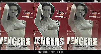

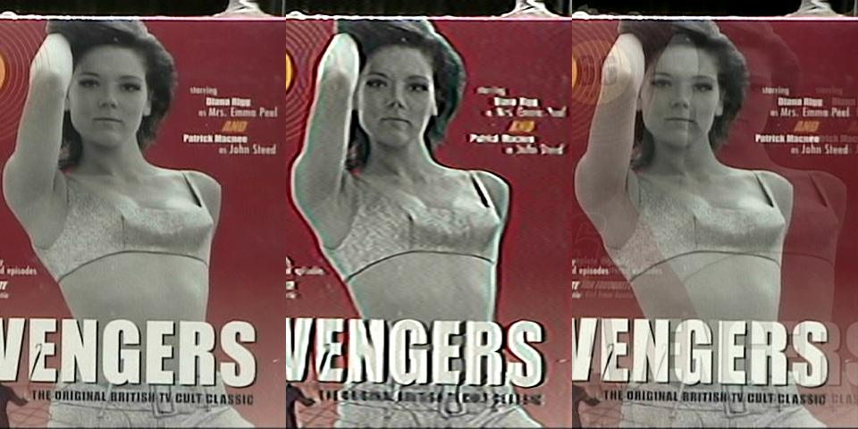

  11. I think you need to clarify what you mean by ghost. Are you talking about over sharpening halos (a lot of people call it ghosting) or true multipath ghosting?
    Clean, over sharpening halos, multipath ghosting:
    You might be able to clean up over sharpening halos by turning down any sharpening filters in the devices in question. Multipath ghosting could be caused by bad cables or one of the intermediate devices.

    Jagabo:
    The center picture distortion (ghosting) is what I am experience with my set up, however not that bad. The small lettering (1/2" in a 40" screen) is difficult to read.

  14. Originally Posted by agdex View Post
    Then you have over sharpening halos, not ghosting.
    I went way overboard to make the problems very obvious.
