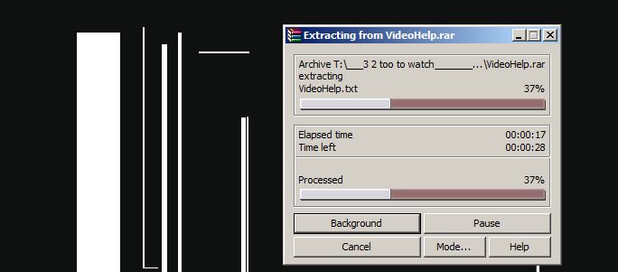

    But dragging the little winrar window leaves white artifacts ALWAYS on the second monitor as I move it horizontally into place.
    Sometimes (about 1% of the time), I'll close a program window on either monitor and it stays there. I think it didn't close and get no response by continuing to try and close it and then check by dragging another window across it and it's wiped away.
    The artifacts can be cleaned up by maximizing anything on that monitor and then un-maximizing it, but that's a pain. I thought this kind of artifact problem with motion went the way of the dodo on CGA video cards long ago.

    In any case, your question about the possibility of a hardware (overheating) problem is not it. The problem is that it draws things while I'm moving them, then fails to erase afterward.
    I'm including a picture to show what it looks like. The white lines and blocks to the left aren't really there covering them up with any part of any window will make them disappear. Well, I thought I was - a window pops up and the top half has two choices to browse and I browse to the file and it shows in the top half. I click "upload" and the file appears as an attachment (after uploading message completes) bottom half of window, but the top half reverts to "no files" the bottom half says 22.3kb and has a 'remove' button, but I see nothing after I close the window to show any attachment. I must be missing something fundamental or it worked and just doesn't show here. We'll see.

    Well, because of microsoft being horrible in a whole new way ... mea culpa ... installing AMD driver 14.501.1003.0 correctly (unchecking the gaming thing) and with no previous driver, I guess it had to install the new one ...
    And no more artifacts!
