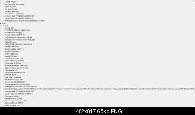

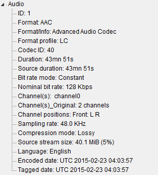

    Here are Mediainfo pics from a similar recording

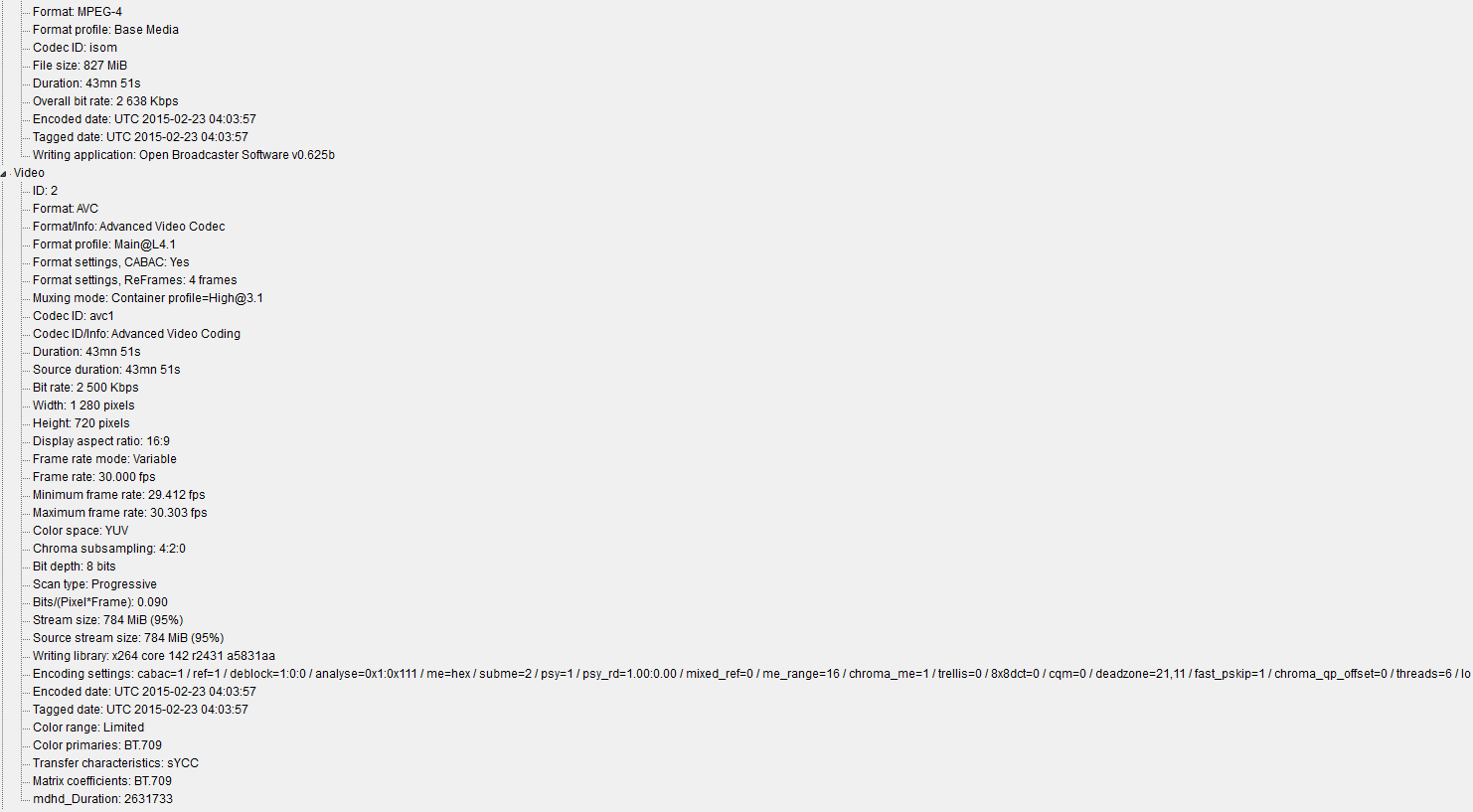

    Ok I tried using recover_mp4_to_h264 again and got this result for step 1: Name:  pic 3.png
Size:  1.4 KB Which seems too small to be usable but i figured i would continue with the split anyway. After step 1 the file sizes go even further down. the .aac file shows 0 bytes and the .h264 is 39 bytes. I did try combining them back together with ffmpeg (using my best guess for a command) and got a message saying that it does not contain any stream for the output video. I am stumped
