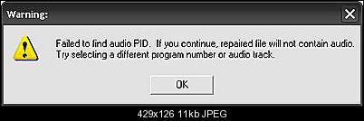

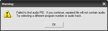

    Hi Tafflad,
    I just ran your sample through MPEG2Repair & it errors with:
  13. Originally Posted by The Mariner View Post
    Hi Tafflad,
    [Attachment 31771 - Click to enlarge]
    Another option knocked down .... amazing how many so far - thanks for trying
