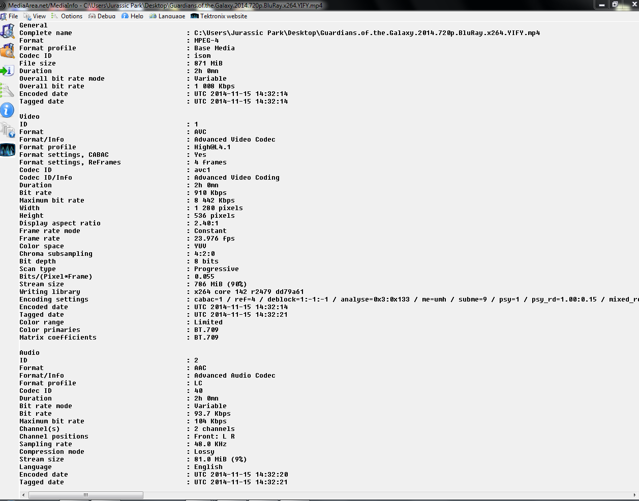

    @BaldrickImage
    [Attachment 31691 - Click to enlarge]
    I capture picture,so you can see all info(i hope).
    @poisondeadhray
    I tried on 2 Blu Ray players,3 DVD Players,and 2 PS3.
    If it's NTSC it always twitch.
    You guys have any advice?

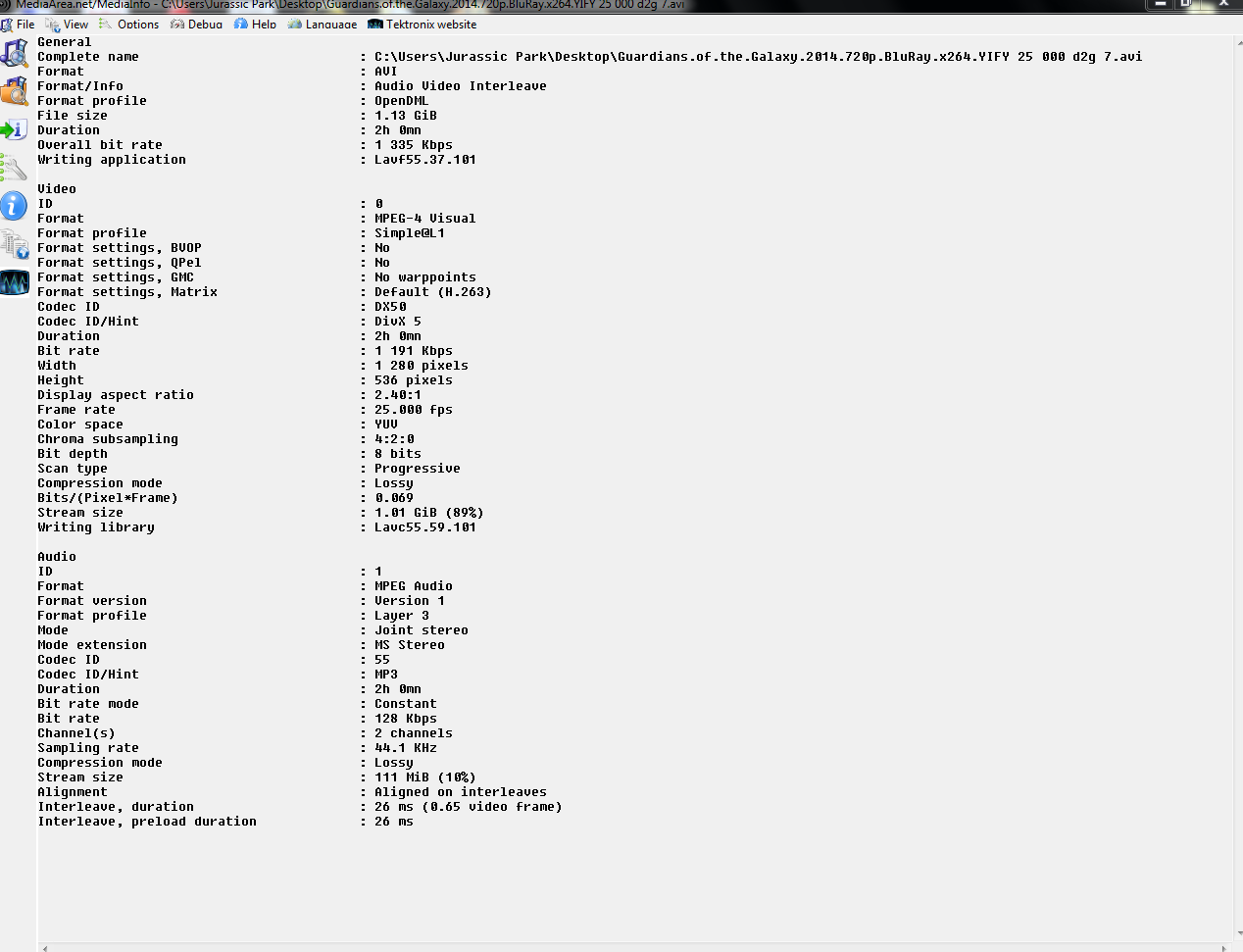

    Here is new,converted video 25p and itImage
    [Attachment 31692 - Click to enlarge]
    's still don't work

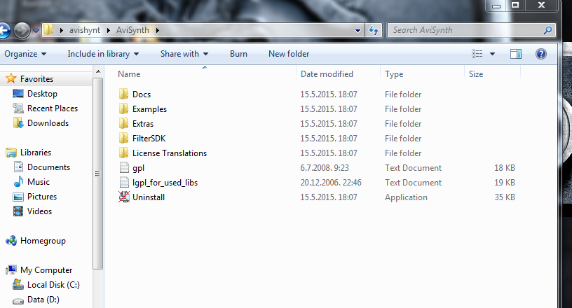

  11. I downloaded and ''install'' AviSynth but i can't get it work,since it has no application that can run it?
    I only get this in folder i installed it(picture):
    [Attachment 31693 - Click to enlarge]
    any advice?

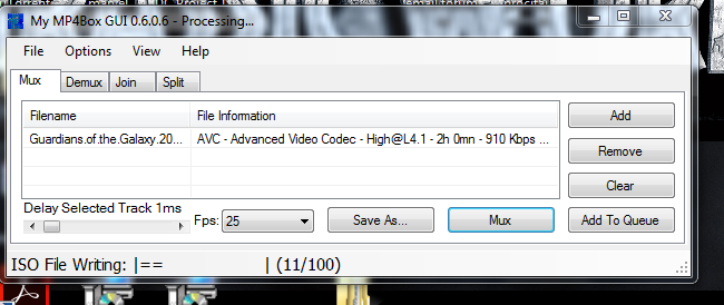

    I downloaded MP4BOX and i put 25FPS,but I'm not sure what to do next?
    Here is how it looks:
    [Attachment 31694 - Click to enlarge]
    I really apologize for being boring,but this means much to me.

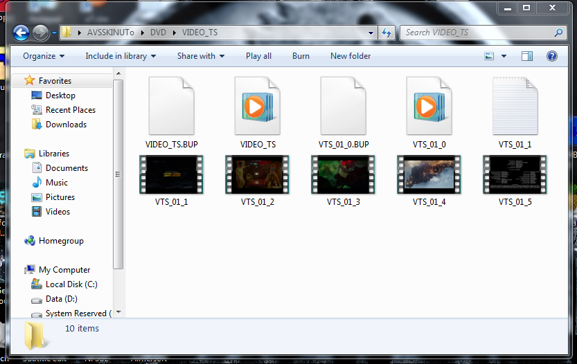

    When i coverted movie from NTSC to PAL,i got audio_ts and video_ts-audio_ts is empty,while in video_ts i have 5 parts of movie.
    I joined those 5 parts,but i get 30FPS when i do that.
    I need to adjust subtitles wiht Subtitles workshop,but i can't get avi/mp4 fromat to do that.
    I'll puting image of what i have in Video_TS.Image
    [Attachment 31719 - Click to enlarge]
    Can you please tell me what should i do next?
