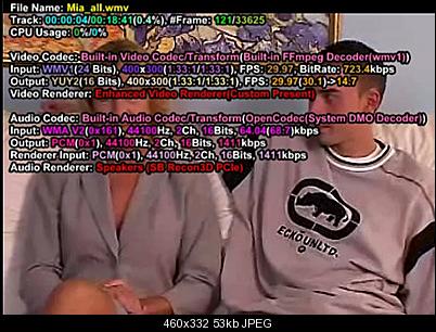

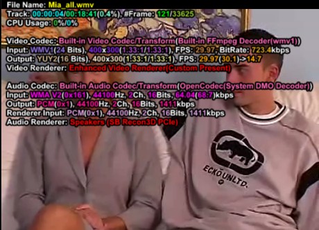

    Right out of the box defaults, just hit the tab key to display on screen information and then hit 'F' key for forward and 'D' key for backward when near your target

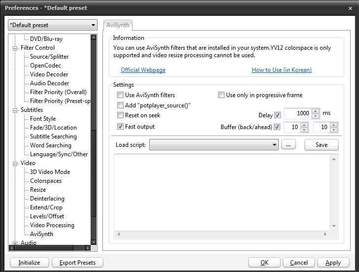

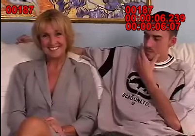

  6. To use the script with any video files..

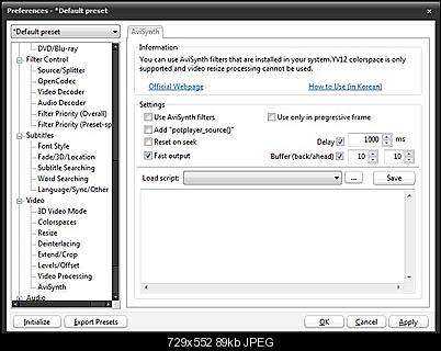

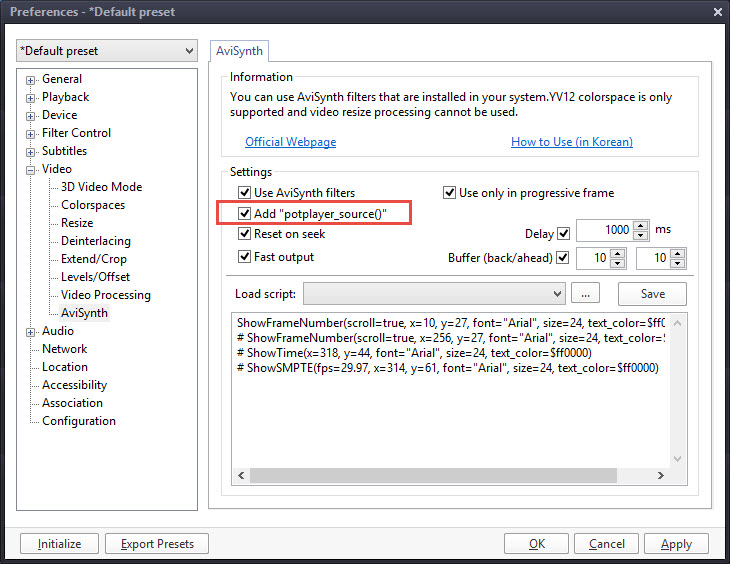

    Thanks for your suggestion. I kind of got it working with the "potplayer_source()" setting, but there are some issues: if I only play the video forward, the frame number displays fine. But if I seek backwards or previous frame, the frame number gets totally messed up.
    My Potplayer Video Avisynth settings:
    I had to uncheck Buffer (otherwise frame number was off by 2002 frames).
    I had to uncheck Reset on Seek (otherwise frame number would reset to 0 whenever I seeked).
    Fiddling with the Fast Output, Use Only in Progressive Frames, Delay checkboxes did not seem to make a difference.

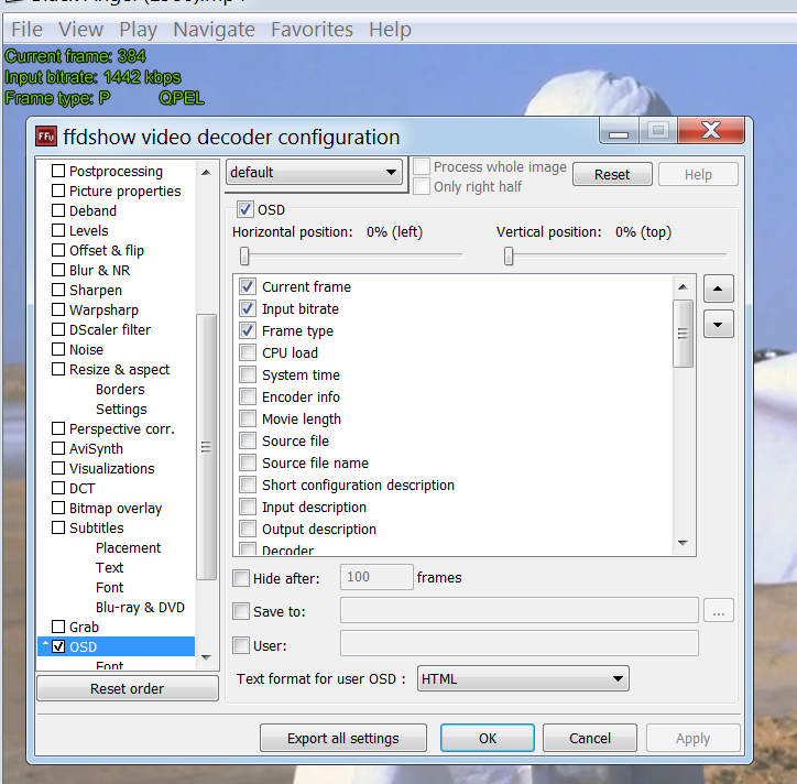

    if you disable the internal decoder for the compression codec you can use ffdshow to do the decoding. It has the option to add all kinds of info, including frame number.
    Thanks jagabo, ffdshow ended up being the solution that worked reliably to give accurate frame number even with seeking back and forth and next/prev frame.
    For the future benefit of other noobs like myself, here are the steps to do that:
    Open ffdshow video decoder (match 32 vs 64 bit with Potplayer)
    Codecs > set Decoder to libavcodec for the formats that you want
    OSD > check OSD, Current Frame
    In Potplayer, change Filter Control > Video Decoder > set to System Default for the formats that you want

    As it turns out, ffdshow displays 'Current Frame' on some of my mp4 files, but it doesn't work on files which are from a Sony camera.

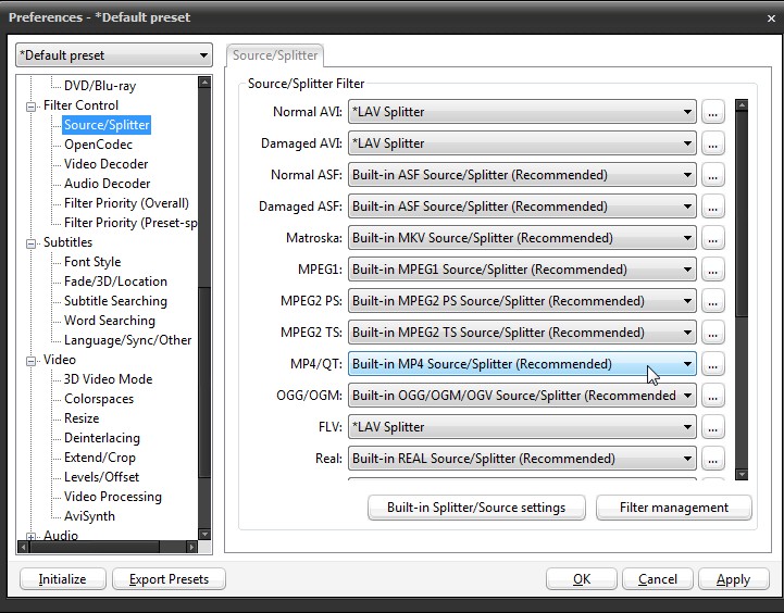

  19. You must also disable Potplayer's internal MP42 decoder. That's probably the Divx or Xvid decoders.
    Right click on Potplayer while the video is playing and hover over Filters. What video decoder does it show?
    You might be out of luck. I don't keep Potplayer up to date. The version I have is a year or two old. But there doesn't seem to be any way to turn off PotPlayer's internal MP42 decoder (that's Microsoft's old experimental MPEG 4 Part 2 codec).

    Following your instructions, video codecs in the list:
    Built-in DXVA Decoder
    Built-in MP4 Source (Greyed)
    Microsoft DTV-DVD Video Decoder (Greyed)
    Enhanced Video Renderer
    In Manage Filters/Source/Splitter, for MP4/QT they have:
    Built-in MP4
    FF MPeg MP4
    LAV (which I assume is there because I installed the LAV decoders).
    I've tried all of them.

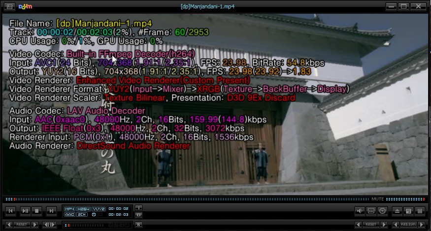

    First thing to do is be sure you are using what you think you are to decode the video. Play the video in Potplayer and hit the tab key.
Name:	ScreenHunter_190 Apr. 08 19.39.jpg

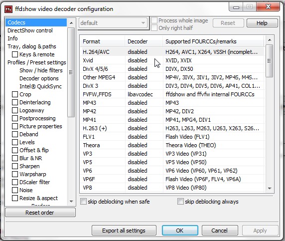

    If it will not play, this is how I have mine set up which works fine. 1st NO ffdshow for mpx or AVC since I let the built in decoders in Potp[layer decode the MP4's:
Name:	ScreenHunter_190 Apr. 08 19.41.jpg

    This whole thing is to let Potplayer use IT's codec and to NOT use it's internal AVISynth but use the one you installed. (Mine is version 2.60). Then write the whole AVISynth script to use it instead of trying to 'tie' it to Potplayers. I'm not saying you cannot do it as described above but to set everything individually to get it to work.
    Bear in mind, if your MP4;'s use different codecs then you may have to use FFDshow, LAV, or FFMpeg. Unfottunately, that is MP4's legacy of AVC, H265, VP4,6 etc. It's not just the the container MP4 but the codec it uses. If Directshowsource fails you can add the ffms2.DLL and ffms2AVSI plugins to the AVISynth plugins folder and use :

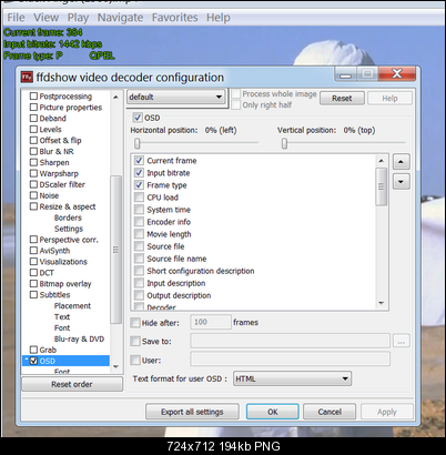

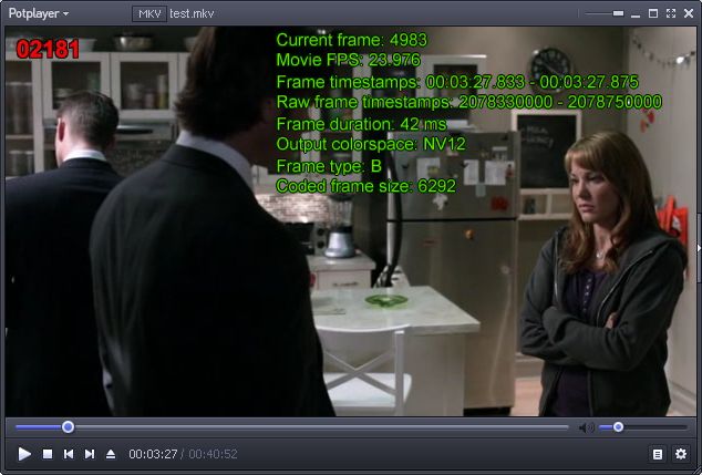

  22. Edit. I see Budman1 beat me to it with another way to skin the cat. Oh well.... now you've got more options.
    If you happened to be using MPC-HC this would be easy. Enable ffdshow's RAW Video decoder at the bottom of the codecs list, open a video with MPC-HC, the video is decoded by MPC-HC as usual, ffdshow pops up to process the decoded video and it's filters are available to use. You can enable it's on screen display, or add stuff to it's Avisynth filter etc.
    Unfortunately though, the second option.... adding stuff to ffdshow's AVIsynth filter to display the frame number.... appears to be a waste of time. I kind of remember something about it being designed so people couldn't do silly things such as add AssumeFPS() to the AVisynth filter section because then the audio and video would want to play at different speeds. Maybe it's something to do with that, but it seems Avisynth has no idea where it is. Skip backward and forward and the frame count just keeps progressing. Given Potplayer seems to be mostly a collection of bits borrowed from other players and software, it possibly explains why it's Avisynth filter behaves the same way.
    If you try the following method I think it'd be an idea to reset Potplayer first and start again. There's an Initialise button in Preferences. From there it should be easy......
    Open ffdshow's video decoder configuration and enable the RAW Video Decoder under the list of codecs, then disable everything else. You can leave some codecs enabled if you want to, but once Potplayer is configured all you should need is the RAW Video Decoder enabled for ffdshow to process the decoded video, regardless of the format.
    With that done, venture into the labyrinth known as Potplayer's preferences, and select Filter Control - Global Filter Priority. Click on the "Add Registered Filter" button. As you may have guessed, "ffdshow video decoder" is the one you need to add. When you've added it, highlight it, then on the right change the priority to "Prefer". Any of ffdshow's enabled codecs should now take priority over Potplayer's built in decoding, but all you should need for ffdshow to run is to have it's Raw Video Decoder enabled.
    That should be it. Open a video, Potplayer will decode, ffdshow will do the raw video processing, and you can use ffdshow's filters including it's on screen display. Or alternatively it won't work at all..... whatever the case may be.
    If not MPC-HC and ffdshow seem to play well together.
    Here's a ShowFrameNumber() script loaded into Potplayer's Avisynth section and displaying "some number" on the left (if anyone knows how to make it work properly I wouldn't mind knowing) and ffdshow's on screen display on the right. You can configure what displays and what doesn't. You may need to change renderers if it doesn't work, although it shouldn't matter. I was using "VMR 9 Renderless".
  23. Originally Posted by pixeldroid View Post
    Built-in MP4
    FF MPeg MP4
    For the record, a splitter won't change how a video is decoded. The splitter splits off the various streams for the decoders.
    The only way to change whether something is decoded is to change it for a particular type of codec. It could be mpeg4 in an MKV, or an MP4, or an AVI, you'd need to disable the decoder for that particular codec.
    If your MP4 files contained Xvid encoded video, it appears for Potplayer you'd disable Xvid under Filter Control - Video Decoder. Changing it to "system default" should result in an installed codec.... ffdshow or LAV...... decoding the video for any file containing Xvid.

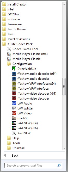

    The overlay settings for ffdshow are set independently of the player, so changing the settings in one app changes them in the others that use it.
    Here how to open ffdshow settings by themselves:
    C:\Windows\SysWOW64\rundll32.exe "C:\Program Files\ffdshow\ffdshow.ax",configure

    ShowFrameNumber(scroll=true, x=10, y=27, font="Arial", size=24, text_color=$ff0000)
    Is that any different to opening it with a shortcut in the start menu? ffdshow usually creates them.
    After installing the ffdshhow filter as described above, it's settings can be accessed by double clicking - again any changes will be applied to any application that uses it.
    ffdshow's icon should appear in the system tray when it runs. I wrote something about that not being the case when it's added to Potplayer as a filter, but it seems that was wrong so I deleted it.
    You can open multiple instances of a player and each can use different ffdshow settings. You can switch between presets or enable/disable filters etc by right clicking on the appropriate ffdshow icon. The configuration only becomes "common" when it's saved and then only for new instances of ffdshow.... or when an instance of ffdshow closes that'll be the configuration for next time it runs.
    You reminded me of ffdshow's "preset autoloading".
    Preset "A" could be set to load when MPC-HC runs ffdshow, Preset "B" could be set to load when Potplayer opens ffdshow. Preset "C" could auto-load when any player opens a video with a resolution of 720p. What if you could make copies of Potplayer.exe with different names. Would it get upset? If not each could load a different ffdshow preset.
    I'm not sure if the auto-loading of presets will work when ffdshow is being run as a filter in Potplayer, but it can't hurt to try.
    One more way to get to the ffdshow configuration..... go to the filter section in Potplayer's preferences where ffdshow was added, highlight it and click "Filter Information".

    Create a text file, and add the following to it:
    Colorbars()
    Save it and change the extension from txt to avs. Open it with MPC-HC or Potplayer. You can just drag and drop it onto the player window. Do you see colour bars?

    I also added this to the aviSynth Script pane in PP:
    LoadPlugin("C:\Program Files\DAUM\PotPlayer\Plugins\ffms2.lib")
    Still no display.

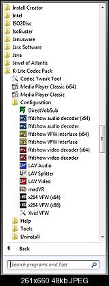

  30. pixeldroid,
    Thinking about it...... because being an XP user I hadn't until now........
    Around Win7 Microsoft decided they want you to use built in Windows codecs. Players such as Potplayer are free to use their internal decoders, but ask Potplayer to use a system codec and for some types it'll always use the Windows codec even if you have another codec installed and enabled. I suspect when you set ffdshow to decode MP42 video, even if you told Potplayer to use a DirectShow codec it'd use the Microsoft one, and not ffdshow, hence the frame number not being displayed by ffdshow's on-screen-display because ffdshow wasn't decoding.
    Would that be correct? The ffdshow icon wasn't appearing at all for mp42 video? If so, that'd be where the Preferred Filter Tweaker is required for Win7 or newer, so enabling any codec in ffdshow's configuration will work. K-Lite probably tweaked things for you when you installed it. If that was the problem, I've decided I should be forgiven for not thinking about it as I don't use Win7.
    http://www.codecguide.com/windows7_preferred_filter_tweaker.htm
    You should still be able to add ffdshow to Potplayer as a filter and used ffdshow for any type of video it supports, but not always via the normal DirectShow method without the Filter Tweaker fixing Microsoft's changes.
