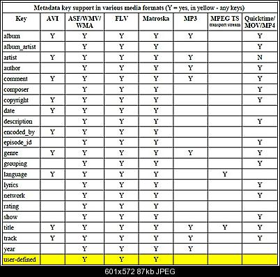

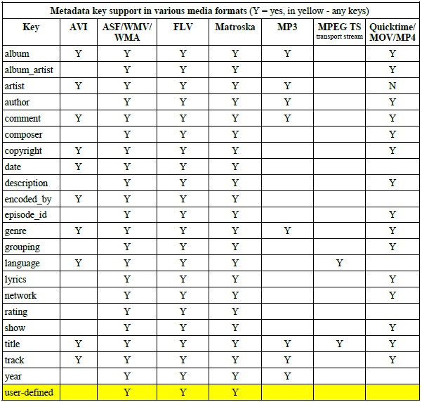

    It is telling FFMPEG which metadata to use, in this case track 0 of the video. Bear in mind each file type has different allowable metadata designator:
Name:	ScreenHunter_140 May. 15 01.35.jpg
    Generally to add NEW metadata:
    location : Rome, Italy
    camera type : SONY
    camera mode : movie
    weather : rain
    y
    In it's simplest form, we can use the command:
    ffmpeg -i videoname.avi -metadata location="Rome, Italy" -metadata "camera type"="SONY" -metadata "camera mode"=movie -metadata weather="rainy" videoname.wmv

  3. Originally Posted by Budman1 View Post
    [Attachment 31687 - Click to enlarge]
    camera type : SONY
    camera mode : movie
    weather : rain
    y
    UPDATE: This page has tons of information on Metadata:
    http://ffmpeg.org/ffmpeg.html
