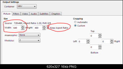

    Yes eventually it will get resized by the playback or display device, but when a DV AVI is converted to say MKV using a program like Handbrake, then doesn't it do that whole aspect ratio and par thing where it resizes to 480*1.33 = 720*.89 = 640 ? Thats what lead me to believe that the converted file itself is resized in the first place. If that is not true I'd be happy to know but then where and how does 640 come into the picture ? In Handbrake when the Anamorphic option is disabled ('none') it automatically flips the resolution to 640 from 720 (shown below).
    If you mention "rectnagular pixels", please do explain with an example which display device could have rectangular pixels ? How do they physically exist ? That is one thing I have never been able to understand.Click image for larger version

    Rectangular pixel is a figure of speech, they do not exist. What player does, when encountering anamorphic video, is reading aspect ratio.
    Assuming playing NTSC DV avi using monitor, aspect ratio is 8:9(that is standard for NTSC DV 4/3). So Player knows that he has to stretch horizontal resolution using that storage aspect ratio (or whatever it is correctly named). It uses whatever algorithm to do it. For example, if you set player to full screen (1920x1080) it renders 1440x1080 out of those 720x480.
    Why it knows to stretch it to 1440? First it calculates viewing aspect ratio: 720x8/9=640, then 640/480=4/3. It knows 4/3 is rendering aspect ratio. It knows also your screen aspect ratio of your monitor. So then it figures out what side would touch the edge of your screen, if top and bottom, it upscales vertical resolution to 1080, then sides get black bars to fill the screen - it upscales horizontal resolution 720 into 1440: 1080/480=2.25x was vertical resolution upscaled, so horizontal resolution must be upscaled with same amount: 720x8/9x2.25=1440
    ... that I just made up, calculation cold have gone very different way, but with the same principle, anamorphic video gets just upscaled (or downscaled) .Regular video, non-anamorphic is rendered exactly the same way, except aspect ratio is 1.0 (instead of those 8/9) in those calculations

  7. Pixels have no shape, they are points. When you speak of pixel aspect ratio what you are really referring to is the spacing between those points. So a pixel aspect ratio (more properly called a sampling aspect ratio) of 8:9 means the separation of the points horizontally is 8/9 the vertical spacing.
    When you convert videos you may or may not retain the original frame size. It depends on the software you use, your personal preference, and playback hardware limitations.
