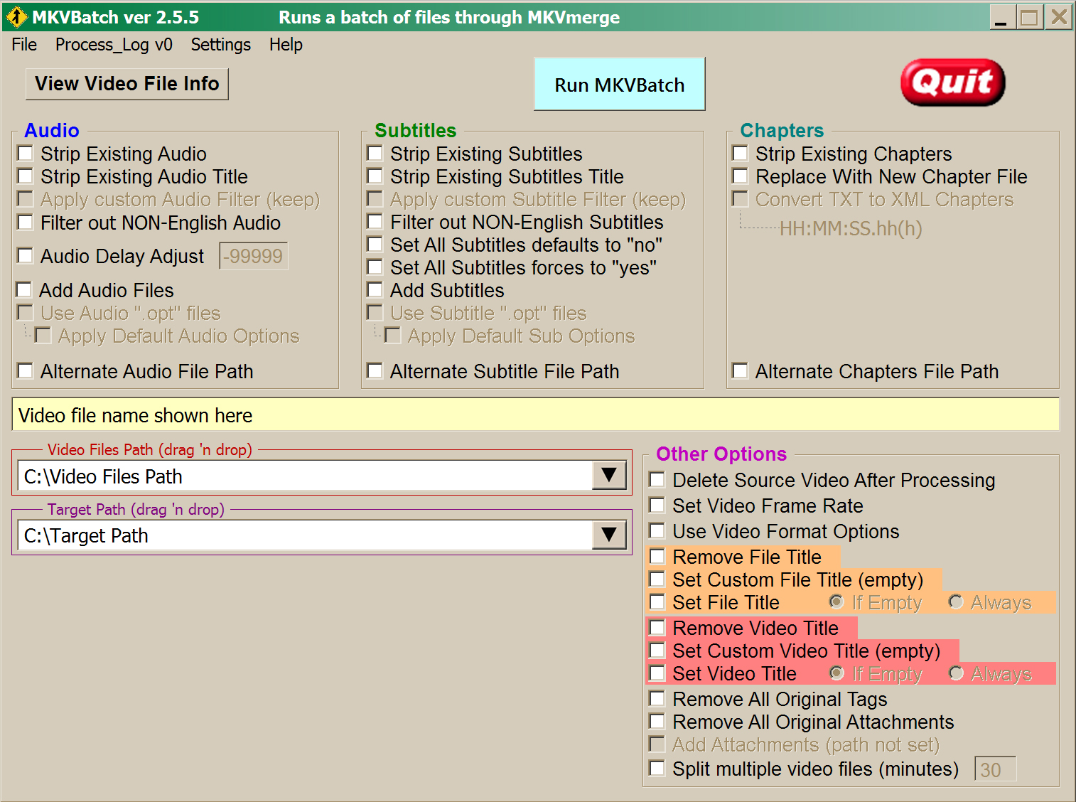

    An upgraded utility to batch merge video files with MKVmerge
    Developed on Windows 7 Ultimate 64bit: tested and working on Windows 10 & 11 . This latest version is 2.5.5; compile date November 4, 2022.
    Requires MKVToolnix v8.9.0 or later to be installed on your system. MKVBatch v2.5.5 uses
    ffprobe.exe, which is supplied (ffprobe v4.1 from the FFmpeg project under the LGPLv2.1)
    Many enhancements and fixes. A comprehensive HELP file is included.
    Please Note: due to changes in how mkvmerge displays data, the "View Video File Info" function requires a copy of mkvmerge v19 in MKVBatch's install folder, otherwise the "View Video File Info" is greyed out. If you never plan to use this function you can ignore this requirement.
    Please post me if you try MKVBatch and especially if you have any issues with it.

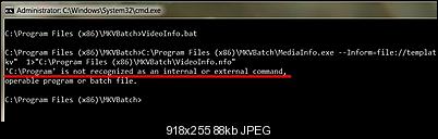

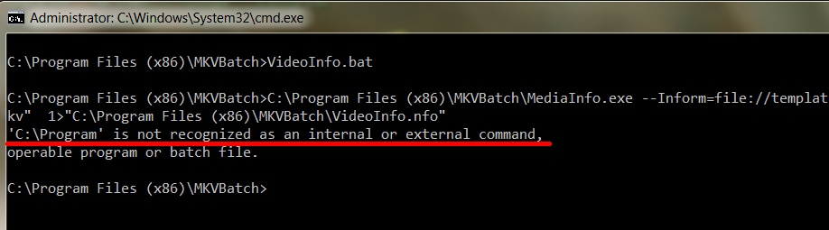

  12. After uninstalling old version, manually deleting MKVBatch folder with old ini, log files and installing 1.0.3 version
    MKVBatch not process with error:
    No process log exists at this time.
            -- Template file 'Template.txt' does not exist.
            -- Creating a new 'Template.txt' file.
            -- The file 'VideoInfo.nfo' is empty
    After running VideoInfo.bat I find the problem:
    Anyway it can be fixed by changing executable path for mediainfo in setting
    Thanks for subtitles options and hard work

    roma_turok:
    Thanks for the feedback and suggestions.
    I took your original suggestion to heart, and went nuts with them. In fact, the tooltips will point out that a popup menu exists for several checkboxes on the main interface. The popup menues require a right mouse click (just like a conext menu) over specific controls. These popups are in addition to accessing these settings through the menu. Well over a dozen popups were created over controls and path boxes. These are all detailed in the help file.
    The fault with running VideoInfo.bat never occurred for me. Thanks for pointing it out; I will track it down and fix it.
