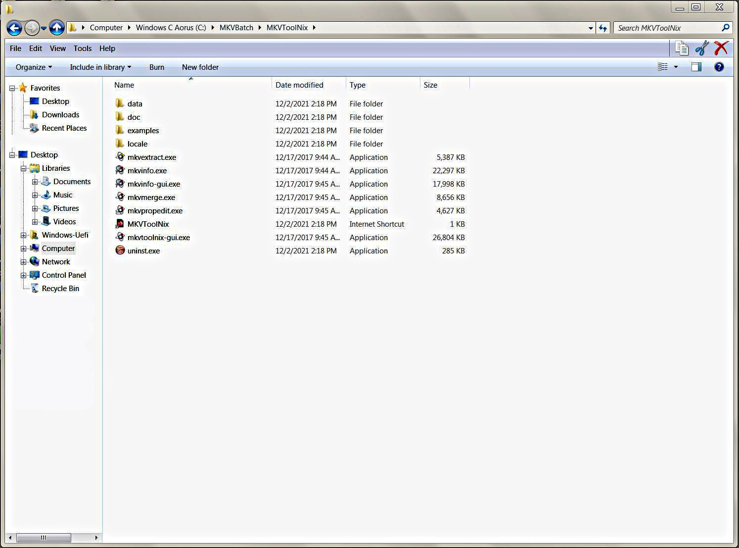

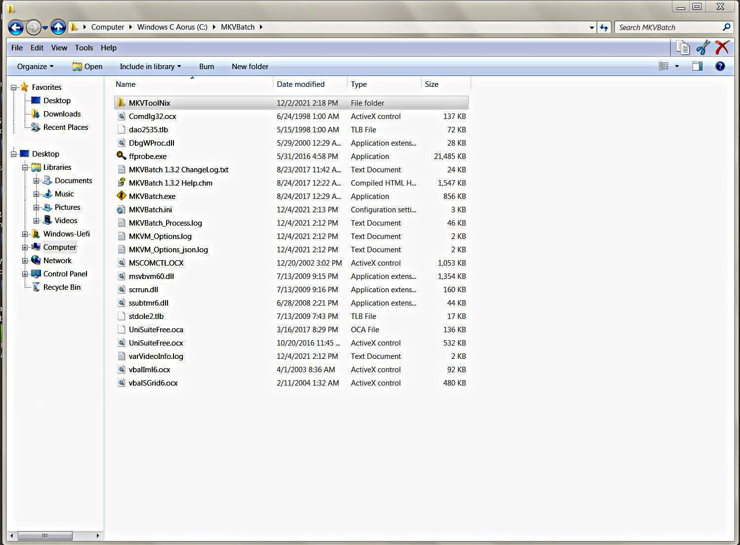

  11. First of all, I wanted to say what a fine program this is (once I was able to get it running). What finally worked for me was to make a MKVBatch folder on the C Drive and installing MKVBatch 1.3.2 there, since for some reason it wouldn't work when installed in either the Programs Files, or Program Files (x86) folders. I then added the version of ffprobe suggested by johns0 on page 3 of this forum to the MKVBatch folder and installed MKVToolNix version 19.0.0 x32 there as well, setting the Executable Paths in MKVBatch to the mkvmerge.exe in MKVToolNix. I hope this helps anyone else wanting to use this program avoid the several days of frustration in setting it up correctly that I experienced, as it is very fast and effective when finally installed and working correctly.

  13. I'm sorry to hear it didn't work for you. Here are two screenshots of my installation to compare to yours just in case there is some difference between the two, other than the Windows versions.
    MKVBatch Folder at the root of C:
    [Attachment 62169 - Click to enlarge]
    MKVToolNix Folder located in MKVBatch Folder:
    [Attachment 62170 - Click to enlarge]
