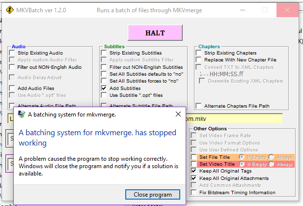

    1.2.0 Still not working on my Windows 10 enterprise machine
    1.0.9 works fine
    I uninstalled completely and then installed 1.2.0 and it keeps giving me this error when i click run:
    i'm using mkvmerge.exe from -> mkvtoolnix-64bit-9.2.0 (i've tried the last 4 versions of mkvmerge.exe, both 32 and 64 bit versions)
    and i'm using ffprobe.exe from -> ffmpeg-20160418-git-13406b6-win64-static
  3. I'm a Super Moderator johns0's Avatar
    canada
    Have you tried running it as an administrator?Works for me on windows 7 64 premium using this ffprobe,might want to see if it works for you.

    alright instead of deleting my post, i'm going to share what i did to get it to work for anyone who might find this in the future
    i simply copy and pasted the mkvmerge.exe file and the ffprobe.exe file from their native directories, to the MKVBatch folder in Program Files, and set the executable paths to use the files from the MKVBatch folder (forgive me if those were the instructions haha)
    thanks librarien

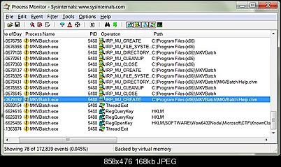

  13. Found small bug
    When selecting Help -> Help
    the program trying open help file by name MKVBatch Help.chm:
    but actual name after install is MKVBatch 1.2.2 Help.chm
    because of that help file not open
    May 2015
    Canada
    roma_turok:
    You're right. I'll correct that problem for the next version. Thanks for pointing it out.

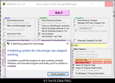

    I keep getting "batch for mkvmerge stopped working " is this good?? John

    Librarien, what causes something to stop working? John

    Will 1.3.0 address the issue of stop working? John

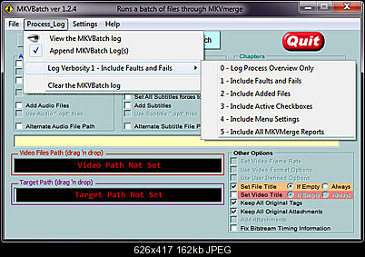

  28. librarien
    Thanks, I will patiently await your new version.
    @RBCC: Please provide more details about what you were trying to do (settings, etc) when the application 'stopped working'.
    Also, take a look at: Process_Log >> View The MKVBatch log
    Your log verbosity setting should be on: Log Verbosity 1 - Include Faults and Fails

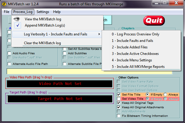

    You recently responded to another user about how the "Log Verbosity" should be set to show faults. You were not quite correct, and after checking the help file I found that it did not explain the verbosity levels clearly enough.
    The different verbosity levels in MKVBatch were intended to show progressively more detail about the functions 'behind the curtain', so to speak. VL1 would include faults and fails, and VL2 would include added files, as well as faults and fails. VL3 would include all active checkboxes, as well as faults and fails and added files. The progression is, each level introduces more data into the log, as well as the data specified in the lower verbosity levels. This is why the different levels are specified as including different information.
    I hope that makes things clearer. Thanks for using MKVBatch and for your comments.
