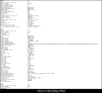

Name:	Screen Shot 2015-05-14 at 12.00.47 PM.png
    note: I've already tried Handbrake (somehow the video/audio suddenly out of sync, maybe drop frames IDK), All-In-One Video Converter (it changes the fps), and of course Compressor.

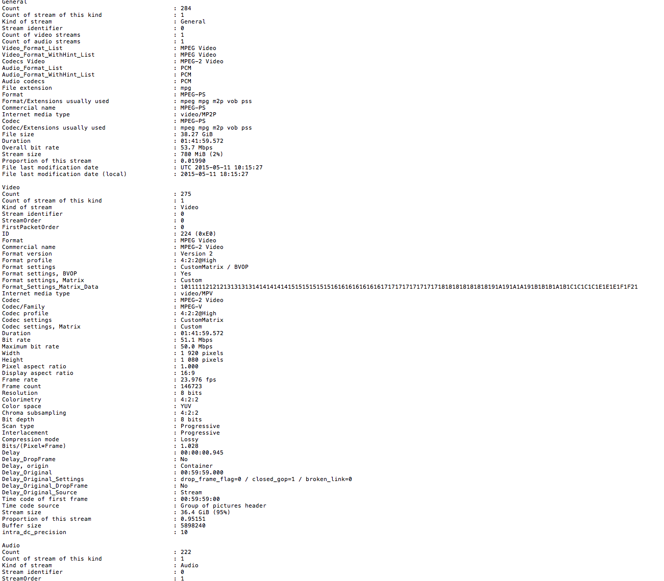

    You made our and your life more difficult by not giving us the audio properties on that screencap.
    Back Up.
    Don't use a screen cap.
    Use a detailed/advanced mode text readout from MediaInfo, and then either copy & paste the text, or do a text mode export and copy & paste the text from the text file. Or even upload the text file.
    Back Up.
