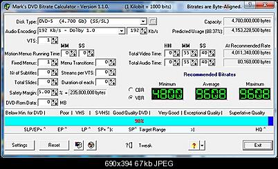

  15. So for current project for mate .. the run time is 55:40 its going to fit on Type 5 and remain good quality
    ... using "Marks Bitrate DVD Calc" it gives me for VBR:

  19. Looking at that BitRate calc and switching to CBR it gives me Bitrate of 9608 so if I used that for CBR .. no problem.
    Read comments elsewhere about not going above 8,000,00, but this should not be an issue then ?
