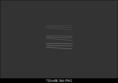

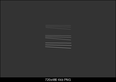

    If your source isn't very sharp it looks ok. But with a sharp source sharp horizontal edges will show artifacts. A 1920x1080 source downscaled to 720x480:
    SeparateFields().BicubicResize(720,240).Weave():
    BicubicResize(720,480):
    It's much worse when upscaling.
