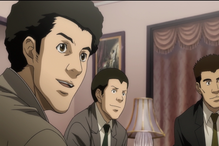

    The one I usually use isn't doing me any good when it comes to retaining fine details. For example, its smearing everything around the letters on this book in his hand even when I turned the strength of the smoother/denoiser lower. Any lower than this setting and it has no real effect at removing the halo's. It was also doing this in other places as well. A common side effect of using deen.
    BEFORE
    AFTER

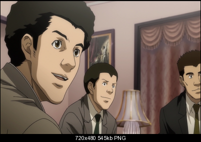

  7. Example:
    Even the halos have halos.

  9. Originally Posted by newpball View Post
    Oh the video, I only looked at the image he posted.
    The images were only meant to show the damage my current dehalo filter I always use was doing to the fine details. Those images werent showing the halo's, thats why I put up the video's.
    There are very obvious halos in the sample video he uploaded.
    What about that second video Jagabo? The first one has it worse than any other episode in the series. That second one is the usual I have to deal with and didn't look nearly as bad. Same filter?
