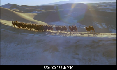

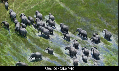

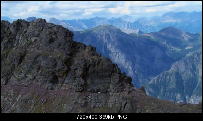

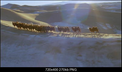

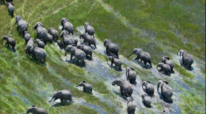

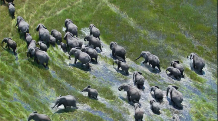

  1. Some people were discussing x264 CRF. The fact is you cannot compare same CRF at different settings because they yield different quality. CRF does not mean same quality; it' s just a method of rate control
    Here is one of the older examples - It's the Planet Earth trailer. I couldn't find the older encodes on my archived HDD's, so I just redid them with the current x264. Yadif(order=1, mode=0) to single rate deinterlace, spline36resize to 720x400 in this example. Ok you can also argue that it's a "trailer" and not "typical" content either... But do enough of these tests, and I assure you will see differences 99 times out of 100
    Typically, you will see lower b-frame quality, and problems where there is motion, expecially with fine details like grass, grain etc....(open the pics in different tabs and flip back & forth) . Using one of the quicker presets , those types details won't be preserved as well. These screenshots below are b-frame comparisons. I'm uploading the source clip and encodes and will update once they are finished
    110 original
Name:	110 original.png
    110 superfast
Name:	110 superfast.png
    110 slower
Name:	110 slower.png

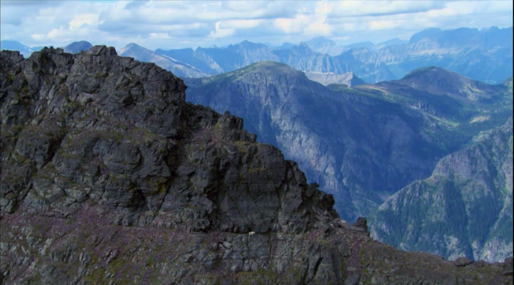

    738 original
Name:	738 original.png
    738 superfast
Name:	738 superfast.png
    738 slower
Name:	738 slower.png
    1166 original
Name:	1166 original.png
    1166 superfast
Name:	1166 superfast.png
    1166 slower
Name:	1166 slower.png
    source clip

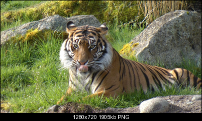

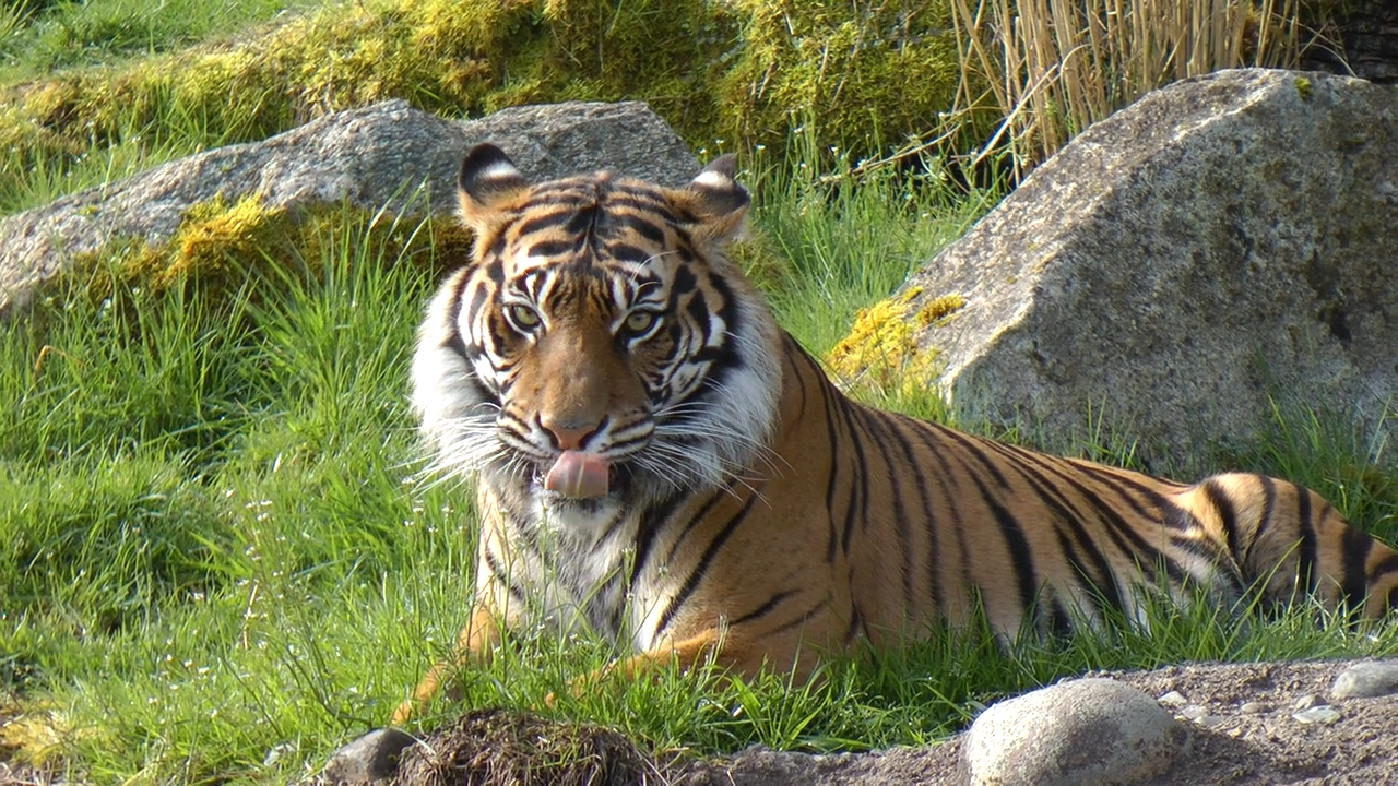

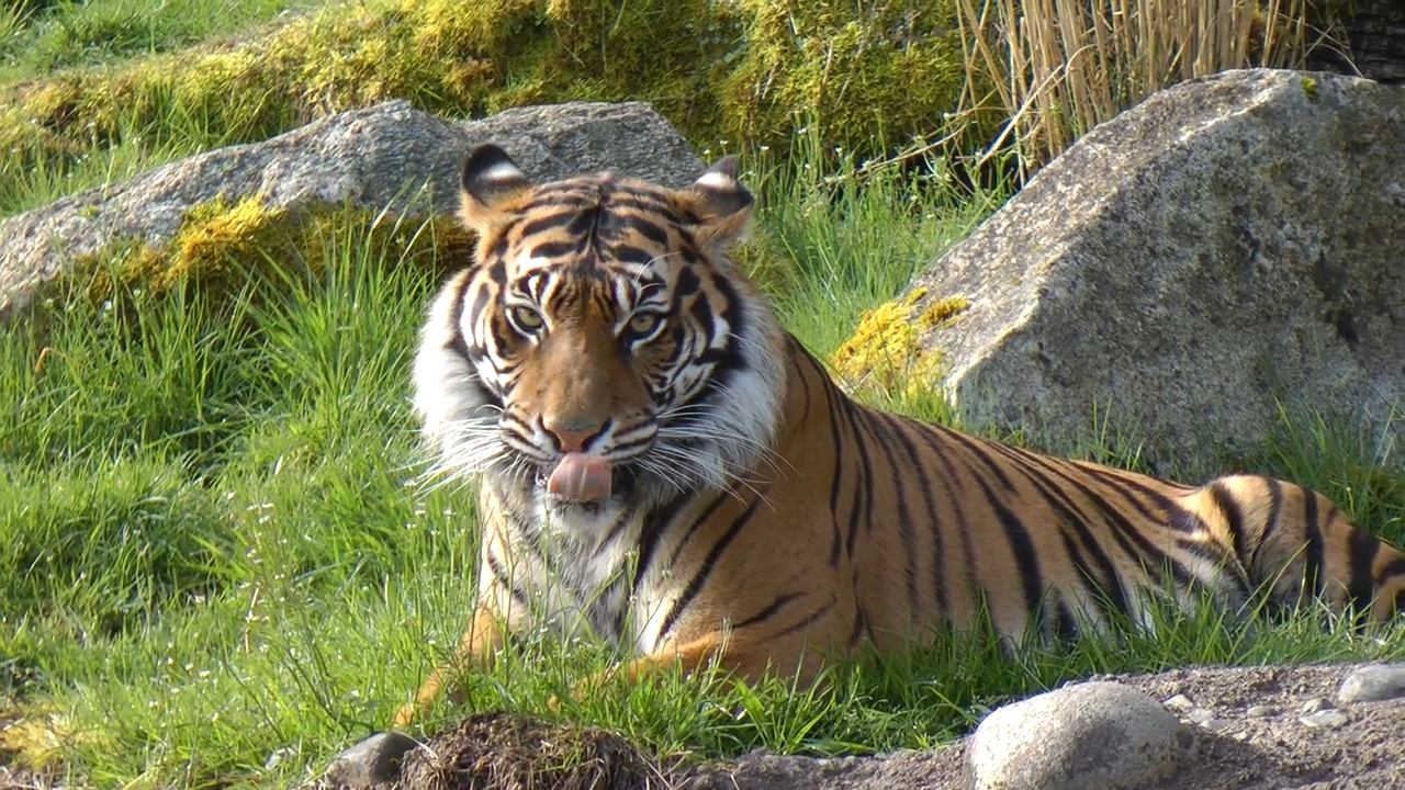

  2. Another example from a consumer camcorder a few years ago. I couldn't find the tests, so I redid them with current x264 as above. These aren't new findings - this has been established years ago with dozens of tests posted (and thousands probably not posted). I just can't seem to find the threads (maybe they were at doom10 which is down now of course...)
    The MTS original clip can be downloaded from vimeo if you are signed in
    http://vimeo.com/10663338
    For the test it was resized to 1280x720p59.94 with spline36resize(), and just a 10 sec section was tested but feel free to repeat the test on a longer section
    Again - b-frame comparions: Notice the fine fur details are obliterated in the superfast encode, also that the file size "trend" is switched (slower encode is actually larger). If you look on other frames, the backround details are reduced as well, the moss is over smoothed for example. This detail loss is typical 99 times out of 100 when looking at quicker settings vs. slower settings for the vast majority of source scenarios. It's not a "cherry picked" example. The only time you might not see differences if source had few details to begin with, or there is very little motion, e.g. maybe some low quality animation
    original
Name:	298 original.png
    superfast
Name:	298 superfast.png
    slower
Name:	298 slower.png
