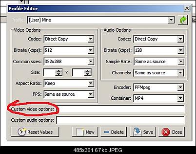

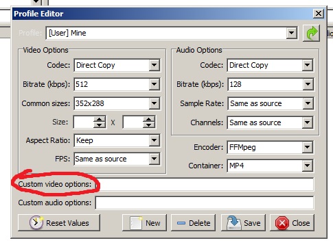

    Tencoder works as well as your script (and keeps the original time codes), but it won't do batch operations with trimming. Is there a piece of your code I can enter in the custom video options to apply the 30 second trim to my files?
  12. Try adding the start time of 30 sec
    --ss 00:00:30
    To re-iterate, this only works because your files are about 1 min long. If they were variable in length, some hour long, some 30 min, etc.... this wouldn't work

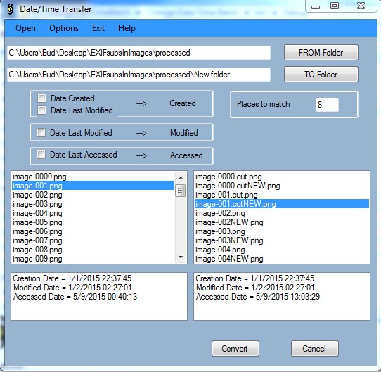

    Fleat, Did you find a way to keep created date? I wrote a short GUI a while back that does a folder full and altered it to match files with added text like PoisonDeathRay suggested. You did mean Windows created date or di you mean the Medi Info information?

    Just wondering and the last accessed is being a bear to change since Microsoft's last update to Microsoft Studios.
Name:	ScreenHunter_140 May. 09 13.04.jpg
