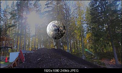

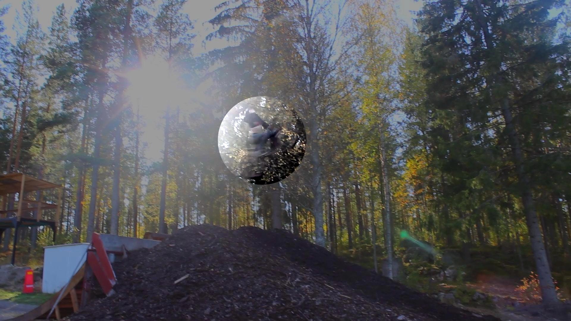

  3. You should consider doing something like this with motion tracking in an NLE:
    The background has the contrast lowered and is darkened. The highlighted circle has the contrast enhanced.
