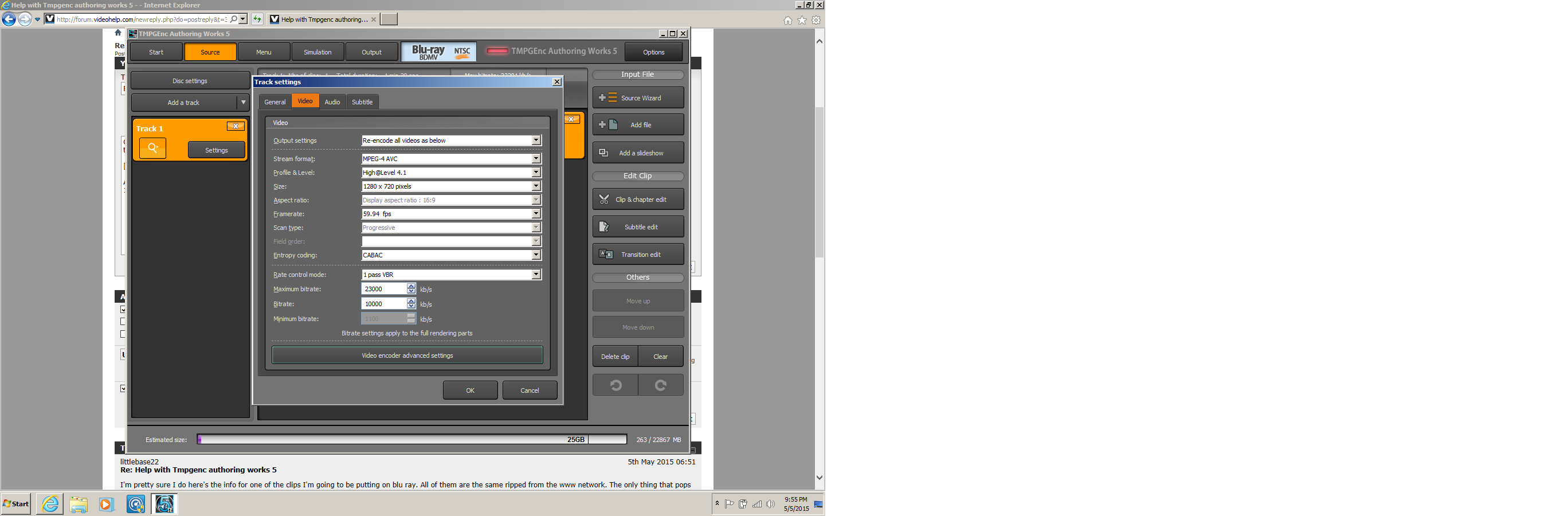

    What x264/h264 settings can you choose? Maybe post a screenshot with all settings.

    I'm pretty sure I do here's the info for one of the clips I'm going to be putting on blu ray. All of them are the same ripped from the www network. The only thing that pops out to me is the fps for blu Ray it should be 59.94 right? That's why I sohuld encode?
    https://forum.videohelp.com/attachment.php?attachmentid=29448&d=1420275143

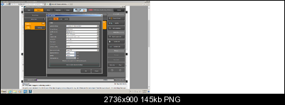

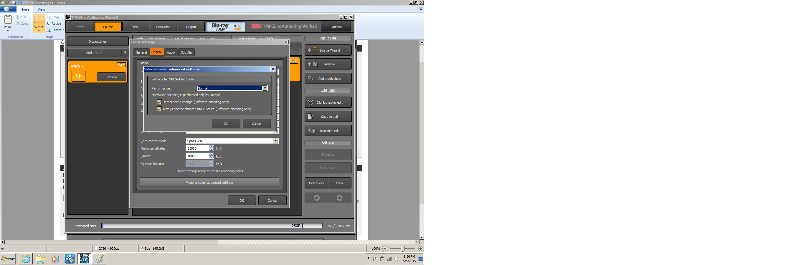

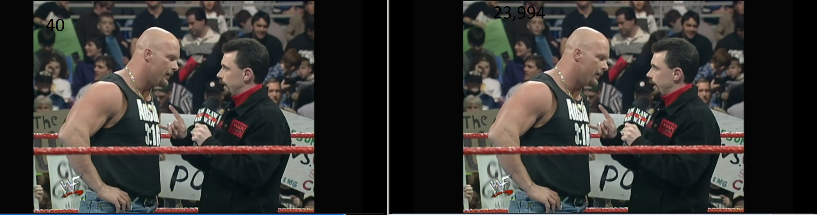

    Ok so I was messing around and did some tests. I made a couple sample clips one with a 40,000 bitrate and one with a 23,000 bit rate. I really cant tell the difference but maybe one of you guys could I make a comparison picture.
    As you could see that is pretty good quality is it necessary to have a bitrate that high of 40,000? It also takes up the whole blu ray lol. Also should I do 1 or 2 pass when using x264 wit taw5? If that clips already pretty good quality would 2 pass make it a little better and how?
    Also heres the settings for x264 in taw5.
ID:	31541Click image for larger version
    The performance stumps me is that just how fast it encodes? Does it effect the quality? Theres a option for very slow. And idk if this video requires 2 pass encoding. Of course I wanna make the blu ray look as nice as possible.
