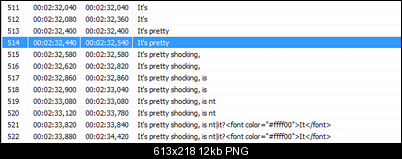

    I am trying to convert teletext from tv tuner recordings to an .srt file, and it seems with different shows the way the captions are formatted is different. I have run into this with a few shows:

    I was hoping there was a program that could go through and combine multiple entries (what is each entry actually called in terms of a subtitle file?) which share text like above into a single entry and give that the starting time of the first combined entry and the ending time of the last. Or even if nobody knows of this feature in any program, a program where I could script that sort of functionality? Not only does having it like above cause the jumpy behaviour because it's adding new words in quick succession (rather than sections of text at a time), but it makes it very difficult fixing timing, and would be much easier with just one entry as I described.

    I currently am using CCExtractorGUI. I am opening the .srt file up to edit in Subtitle Workshop (which is where the screenshot in OP is taken from). As for merging multiple entries, it doesn't have to actually be doing that, I just need the end result as what I mentioned. Finding successive entries that share text like in the OP screenshot and creating a new entry with their text (with all duplicated text removed) and the starting time of the first entry that was combined and the ending time of the last. Then it could delete all the old entries.
    I could do it myself manually by following the process I just described, but that would take a LONG time going through the entire file. So I'm wondering if there is any method I could automate this process? Or any way to record/convert teletext to subtitles in a better way to avoid this completely.
