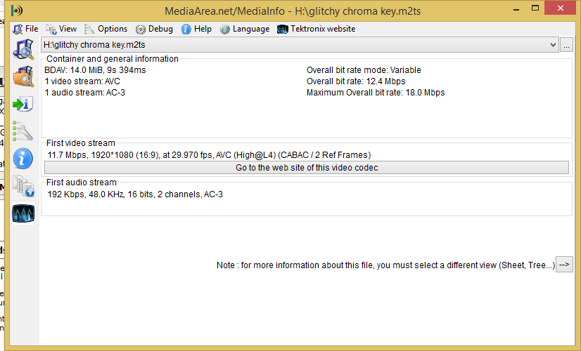

Not 100% what vfc is, but here is a screenshot of the Mediainfo check
https://forum.videohelp.com/images/imgfiles/izqS5S7.png
