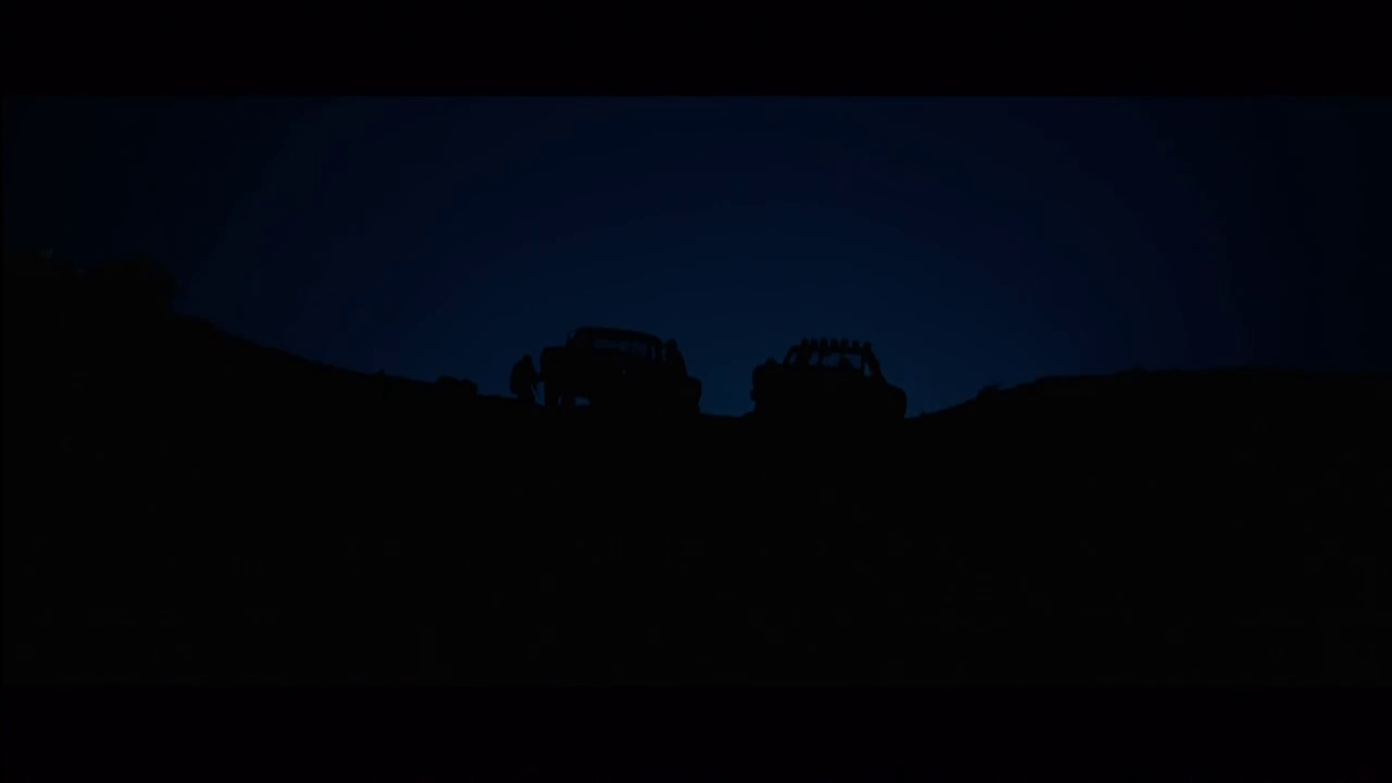

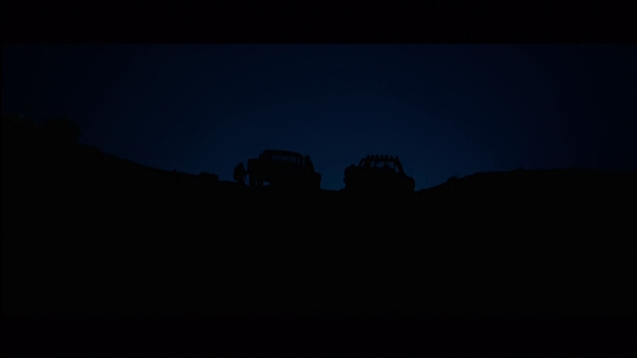

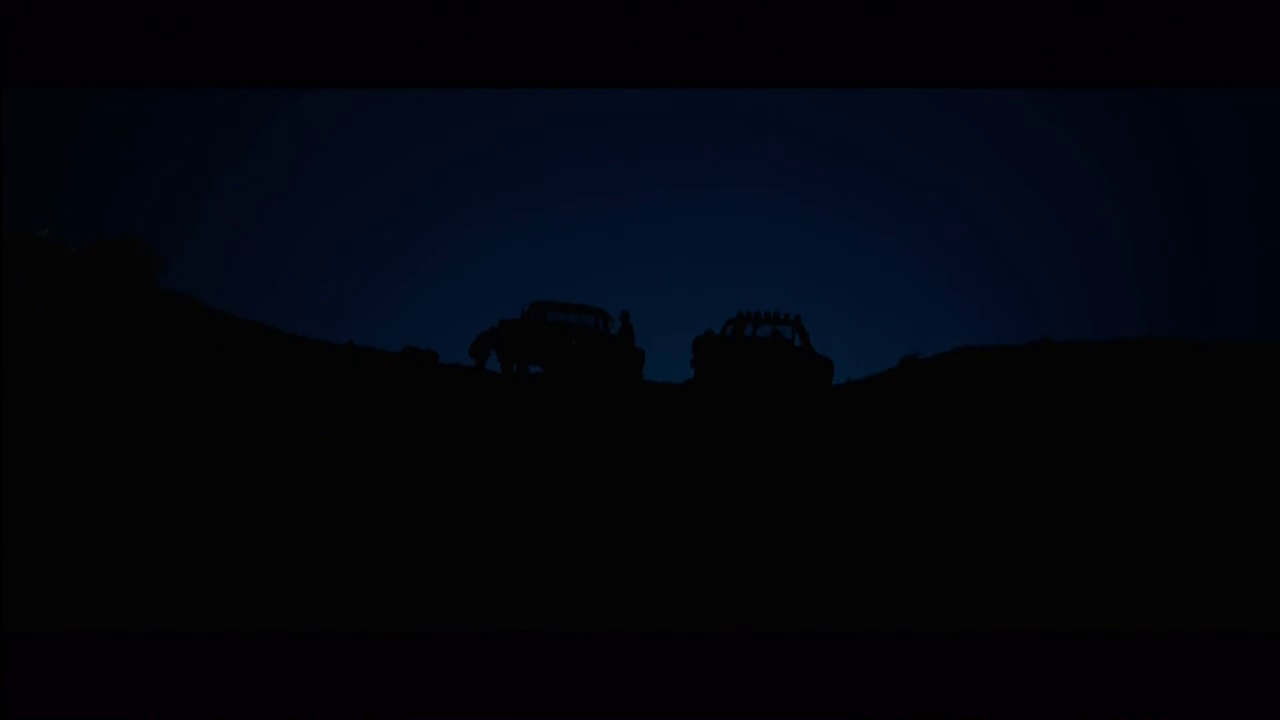

  1. I have been using megui for my encoding of ts captures from the tv, I have been really struggling to reduce/remove banding and dancing pixels in darker areas on the final conversion. Here are two screenshotsImage
    [Attachment 31488 - Click to enlarge]
    [Attachment 31489 - Click to enlarge]
    its not that easy to see but im producing hard blocky edges and need some advice on how to reduce them.

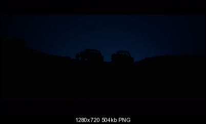

  2. If you're using noise reduction filters -- stop using them. Noise is what keeps posterization artifacts like this from showing up. If they're already in your source you can use an avisynth filter like gradfun2d or gradfun3. But you must use sufficient bitrate when encoding to keep the posterization from reappearing.
    One of your images after gradfun2dbmod():
