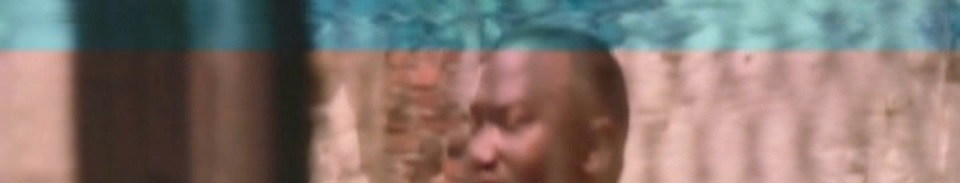

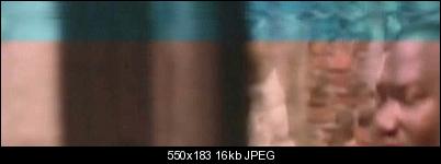

  1. I can't remember exactly but there was a script which could get rid of this kind of defect

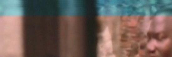

  2. This (mostly) works for a static bar:
    ImageSource("ugk-blue_bar-crop.jpg")
    ConvertToYUY2()
    top = Crop(0,0,width,50)
    bot = Crop(0,50,width,-0)
    bot = MergeChroma(bot, bot.Invert())
    StackVertical(top,bot)

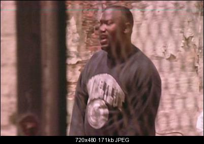

  3. I've found the magic script again in my archives , have a look below Jagabo but i have a problem a small horizontal line is still present if you can give me a hand to tweak that:
    imagesource ("blabla.jpg").converttoyv12()
    # X1 is left, Y1 is top, X2 is right, Y2 is bottom
    X1 = 0
    Y1 = 0
    X2 = 720 # for a 720 wide horizontal bar , change accordingly
    Y2 = 32 # for a top 32 pixels in height horizontal bar, change accordingly
    # Make the values MOD4
    X1 = X1 - (X1 % 4)
    Y1 = Y1 - (y1 % 4)
    X2 = (X2 + 3) / 4 * 4
    Y2 = (Y2 + 3) / 4 * 4
    Active = crop(X1,Y1,X2-X1,Y2-Y1)
    Above = Y1 > 0 ? crop(0,0,width(),Y1) : NOP
    Below = Y2 < height() ? crop(0,Y2,width(),height()-Y2) : NOP
    Left = X1 > 0 ? crop(0,Y1,X1,Y2-Y1) : NOP
    Right = X2 < width() ? crop(X2,Y1,width()-X2,Y2-Y1) : NOP
    Last = Active
    # INVERT HUES:
    input=last
    U = UtoY().Invert()
    V = VtoY().Invert()
    YtoUV(U, V, last)
    IsClip(Left) ? StackHorizontal(Left, Last) : NOP
    IsClip(Right) ? StackHorizontal(Last, Right) : NOP
    IsClip(Above) ? StackVertical(Above, Last) : NOP
    IsClip(Below) ? StackVertical(Last, Below) : NOP
    return Last

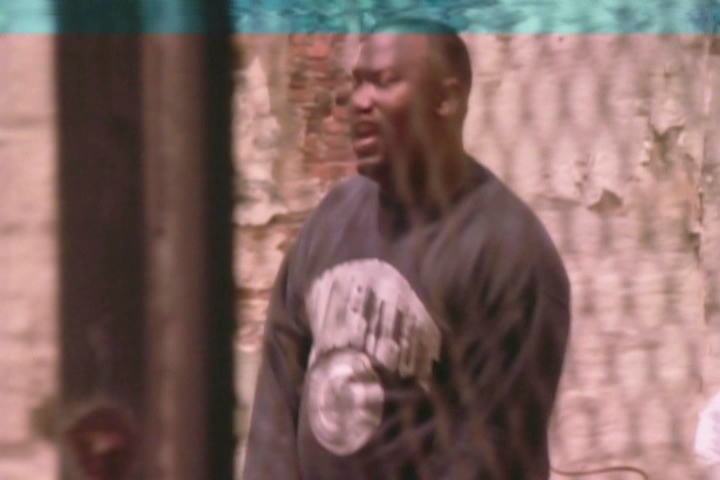

    The image i'm working on:

  4. That's basically the same thing I did except for the reversal of the colors. And the longer script has the ability to split right/left in addition to top/bottom.
    The remaining discolored bar is there because the transition from cyan to brown isn't sharp. No matter where you split the video a little bar will be left. I'd fill the bar with an overlay of colors interpolated from above and below.

  6. Something like this:
    YPOS = 34
    ImageSource("Cyan_bar.jpg", start=0, end=23, fps=23.976)
    ConvertToYV12()
    # first fix the top
    top = Crop(0,0,width,YPOS)
    top = MergeChroma(top, top.Invert())
    bot = Crop(0,YPOS,width,-0)
    # then fix the remaining strip
    top = Crop(0, YPOS-6, width,4) # four lines above
    bot = Crop(0, YPOS+2, width,4) # four lines below
    patch=StackVertical(top,bot).Blur(0,1.0).Crop(0,2,-0,-2)
    MergeChroma(last, Overlay(last,patch,x=0,y=YPOS-2))
    Feathering the edges with an alpha mask will probably look better in moving shots.
