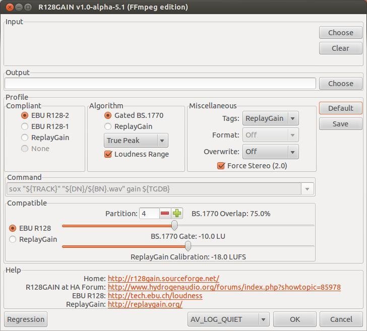

    Technically it can, depending how it's done. If you normalise a wave file to 0dB and then encode it as MP3 or AAC etc, which would be a common menthod, after it's decoding and the waveform reconstructed the peak may exceed 0dB. That's one reason why some people recommend normalising to -3dB, although I'm not sure it's anything to fuss about too much. The newer methods of determining volume have "Peak", and "True Peak" options.
  12. Originally Posted by hello_hello View Post
    Originally Posted by newpball View Post
    Originally Posted by killerteengohan View Post
    I hear normalizing is or can be damaging though and can cause clipping.
    Nonsense, normalizing does not cause clipping.
    However if you normalize to 0 db you have no room for anything else on top of that.
    Clipping may occur in analog domain (assumption is that normalization is last step of signal procession - just before requantization) and as such normalizing to: 1/SQRT(2)= -3.103dBFS is recommended (in practical aspect this is loss of 0.5b i.e. half bit - beyond perception with properly dithered signal - especially with noise shaped dither)
