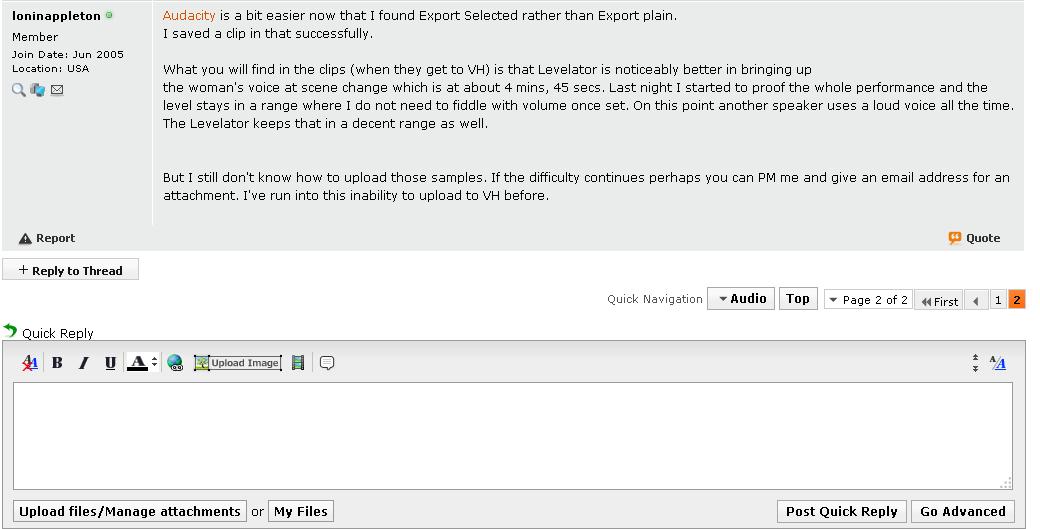

  11. Audacity is a bit easier now that I found Export Selected rather than Export plain.
    I saved a clip in that successfully.
    What you will find in the clips (when they get to VH) is that Levelator is noticeably better in bringing up
    the woman's voice at scene change which is at about 4 mins, 45 secs. Last night I started to proof the whole performance and the level stays in a range where I do not need to fiddle with volume once set. On this point another speaker uses a loud voice all the time. The Levelator keeps that in a decent range as well.
    But I still don't know how to upload those samples. If the difficulty continues perhaps you can PM me and give an email address for an attachment. I've run into this inability to upload to VH before.

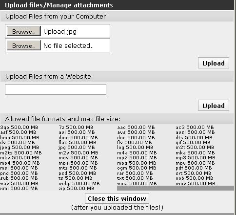

  12. Originally Posted by loninappleton View Post
    Click on the 'Upload files/Manage attachments button below where you type in a response. Then you'll be shown a new box where you 'Browse' to the WAV file, click on the 'Upload' button, and finally 'Close this window' when the upload is complete. You can do a 'Preview Post' to make sure the link to the WAV file is there.

  13. I got that far and a yellow message comes up that says uploading files please wait.
    But it never shows any indication of completion. For example if I used the quick reply form here, I'd want to see them in the same post.....
    will try here:
    This time I see 'sending request to forum and a progress bar half completed....
    I can't see how closing the window when half done would do any good-- still waiting for the
    request to complete.
    I finally just closed it. It's not working.
    Any other option I'll try but not this any more.
  14. Upload it to some filesharing site like MediaFire then. However, although the upload to here usually works (even if it might be really slow sometimes), it doesn't always work, in my experience. You might try again later on.

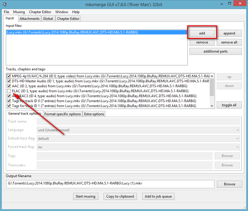

  22. 1. Don't use command line. Use mmg.exe. Its a GUI.
    2. Do not add audio as attachment, use Add button.
    3. If you want to exclude a stream just uncheck box in front of a stream you want to exclude from new file.
    4. mmg (mkvmerge) will not replace your old file, it will create new one because it needs old file to get streams. And in case comething goes wrong you still have old file.

  25. @detmek
    My problem is after loading mmg.exe or the gui (looks the same) is I cannot find my
    .ogg processed file.
    I tried append and some things but was just trying to get the .ogg in there.
    mmg.exe does not automatically find an ogg file in the work folder.
    I don't know that loading MeGUI would be different.
    Is .ogg a recognized file type?
    I will try an extract to see if a demux shows my .ogg. MKVextract will be another new operation for me.
  26. Extract and al;l that was unsuccessful-- everything greyed out and not working.
    On mkvmerge I did the following
    ADD mkv original with subtitles and acc audio (whatevs)
    ADD my .ogg audio file in the same window
    Result:
    Vorbis shows up as the last entry in the selection window you indicate above.
    If I untick everything but the Vorbis file and select mux will the job complete?

  28. It means mkvmerge created MKA file, which indicates that file contains only audio. And yes, mmg supports ogg files.
    Here is an example how to replace AAC audio with MP3 audio and save file as MKV. Not really that hard.
