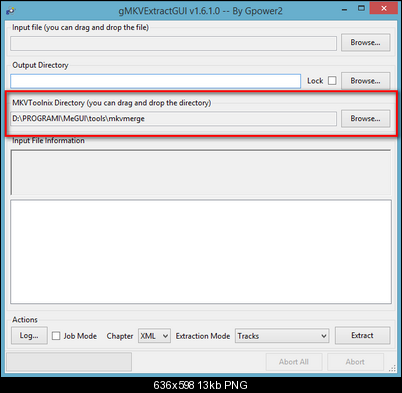

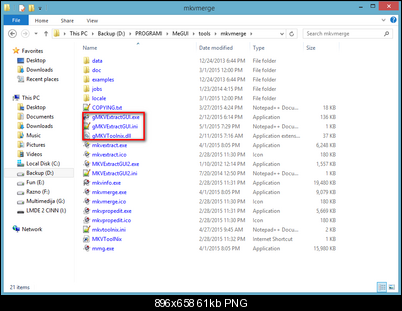

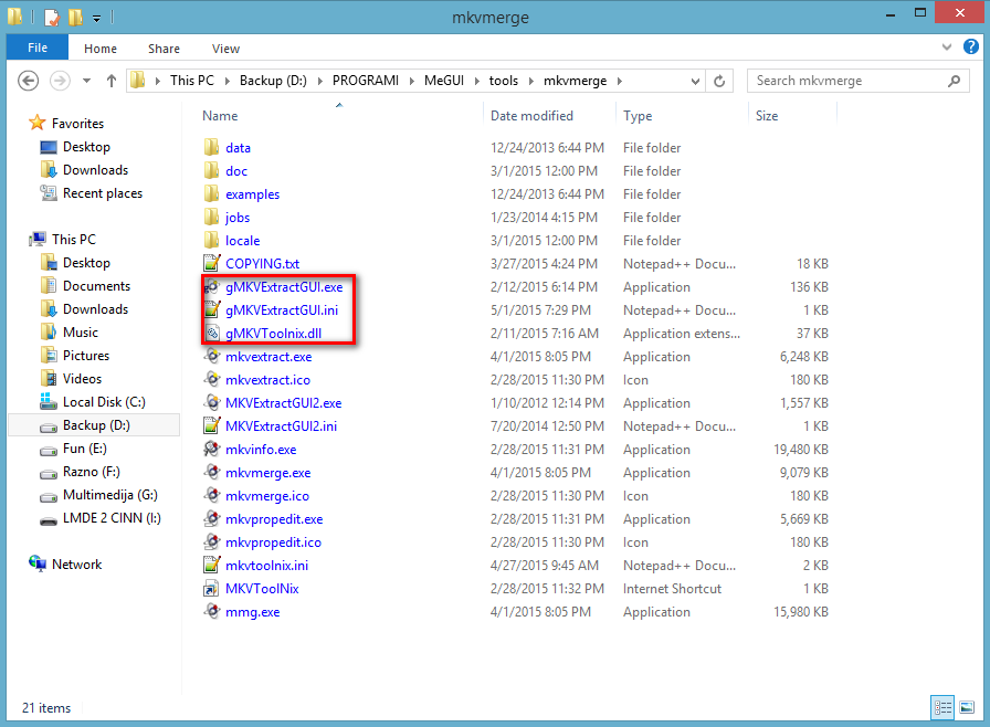

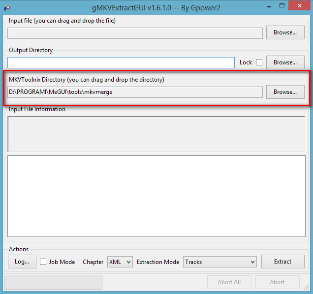

  21. I would use the gui and Toolnix but did not get the right combination of where to move/install the gui to extract.
    Can you give some direction on that. Toolnix doesn't like the gui within its own folder. Taking it out of the folder and putting it in the Toolnix main folder doesn't work either. What's the trick? Also are there other dependencies needed to make it efficient?

  22. It works fine if you put gMKVExtractGUI into MKVToolnix folder. Or you can put it somewhere else and point it to MKVToolnix folder. I use MKVToolnix package that comes with MeGUI.

    MakeMKV should not overheat your CPU because it does not do any compression. It just remuxes streams into MKV containter. It does same thing as MKVMerge (mmg.exe) from MKVToolnix. So, if your CPU does not overheat when you compress video it will not overheat with MakeMKV running.

    Today my goal is to kust get the mkv gui into toolnix. I mentioned I failed and continue to fail.
    When the unzipped folder is opened, there's just an .exe and a readme.
    Running the .exe does not give the .dll and .ini file but just repeats the error of 'put me into the
    toolnix folder. So it's one of these treehouse father and son problems where you don't know unless you know.
    _And_ it's needlessly complicated.
  27. Some Success.
    I used search again in Win 7 and see the ini, and dll files in there, though maybe in a different order.
    the extract gui opened and I did a sample extract. The gui can do video, vobsub and audio. The audio extracted in this sample is 48000 kpbs AC3.
    Ok for that.
