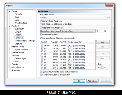

  16. But you need a monitor or a TV which is capable of diplaying 23/24/25/29/30/50/59/60 Hz. XBMC, oh sorry Kodi can also do it . But it is in expert settings.
    Please try MPC-HC otherwise you won't get my arguments. If you don't get it, this discussion is useless.
    needed sttings
