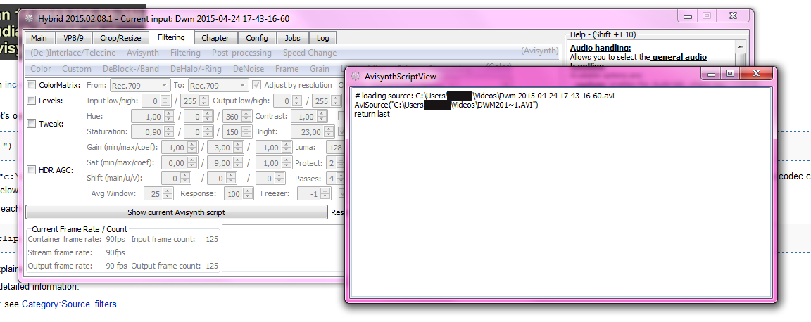

  9. You need to post your AviSynth script. You don't need to use Tweak() to keep the original colors. You just need to avoid screwing it up within the script, when viewing it, and when encoding it.
  10. Done for text view and the script. Files attached.

  24. Ok the problem seems to be color matrix. I changed the source color matrix between Rec.709; FCC; Rec.601; SMPTE 240M and don't touch the output color matrix (which is Rec.709). Results :
    - Rec.709 -> Rec.709 = colors like screenshots here (bad colors for the green)
    - FCC -> Rec.709 = same green like source
    - Rec.601 -> Rec.709 = same green like source
    - SMPTE 240M -> Rec.709 = colors like screenshots here (bad colors for the green)
