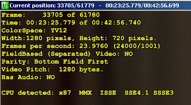

    Or before adding ConvertToYV12() to the end of the script, add Info() and you should learn which colorspace you're working with that way.

  16. Well, i was getting a bit tired the other night and i think Win7DSFilterTweaker actually worked a treat. I've been experimenting just to confirm and it seems that simply changing the H264 option under 'preferred decoders' does what is required. The ffdshow video icon now loads in the system tray as MeGui loads the avs file and info() shows YV12. No 'problem' message when i hit 'queue'.
