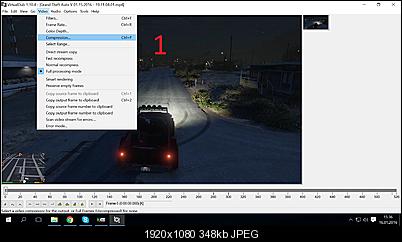

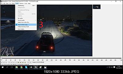

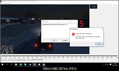

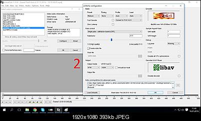

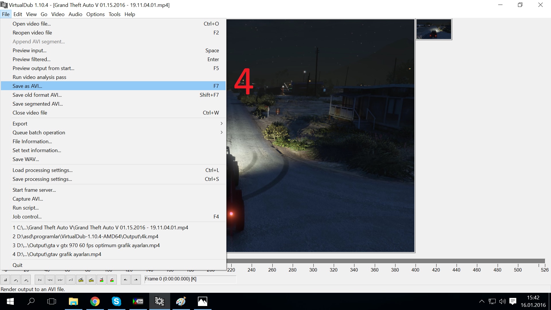

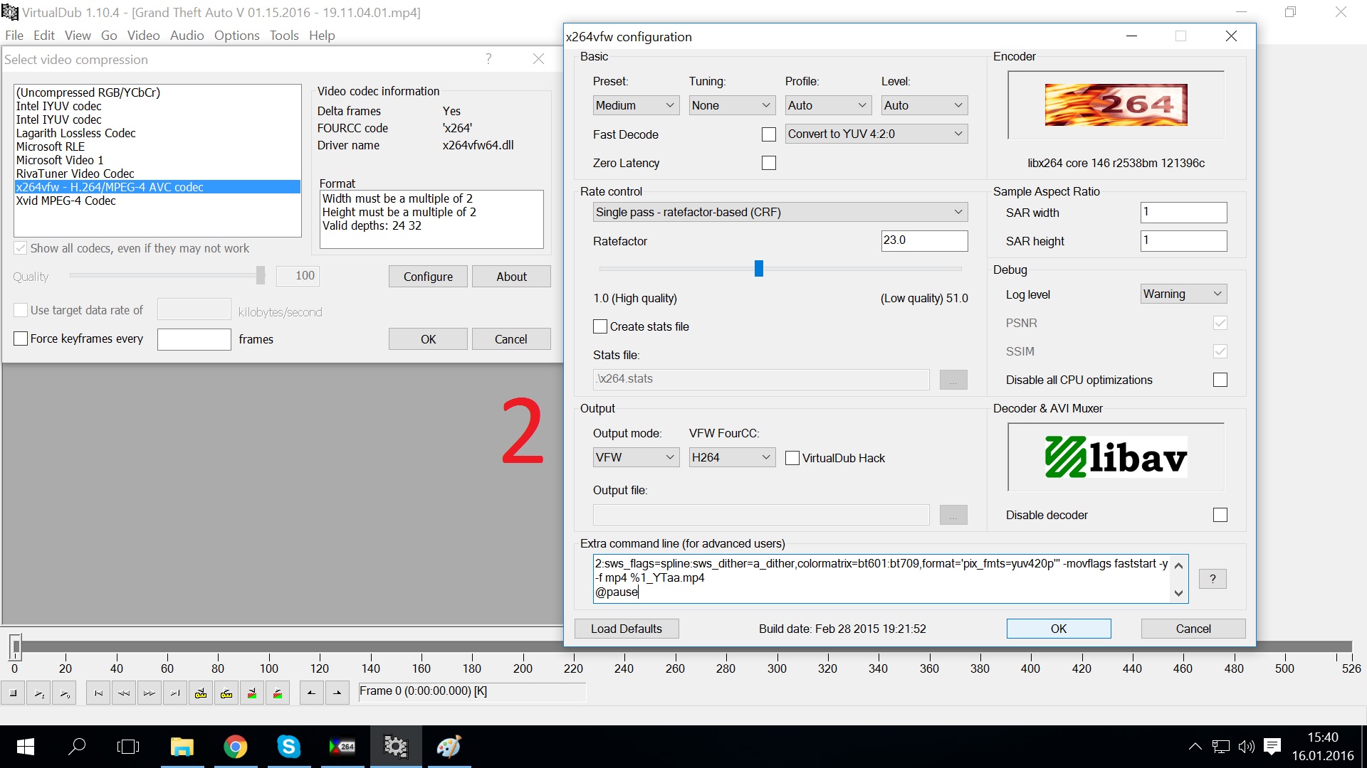

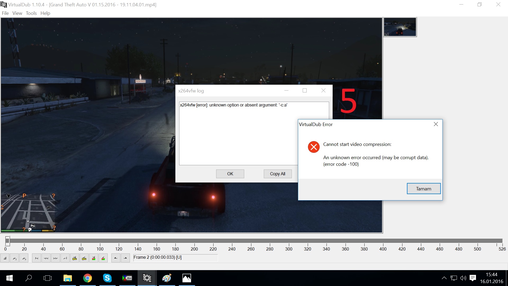

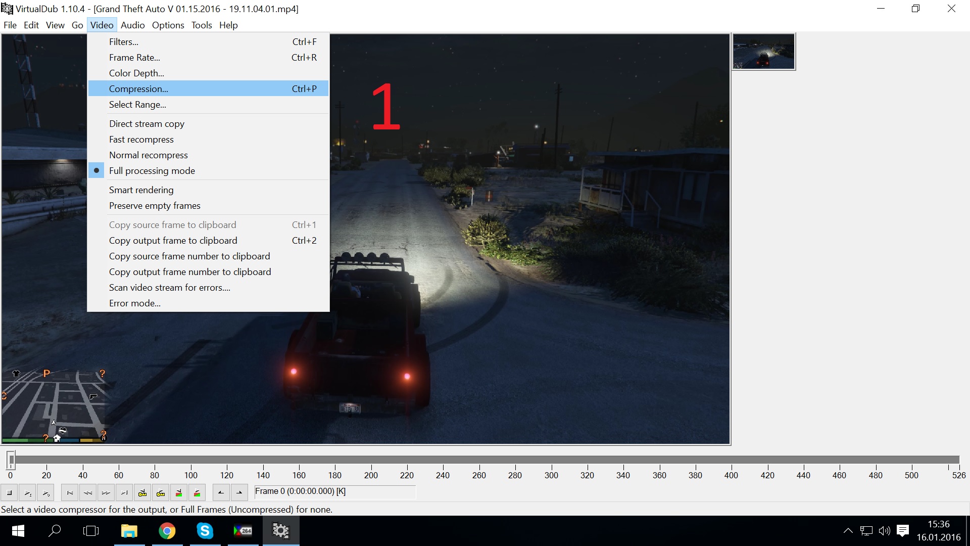

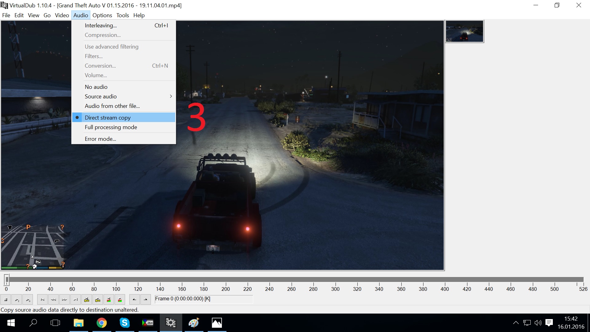

    Hi,
    firstly, sorry my bad english...
    Where I can use your codes? I downloaded x264vfw and paste your code to Extra command line on x264vfw. Then run VirtualDub and configure. I paste your code again. ERROR ...

  17. Originally Posted by pandy View Post
    You can try to recompress source file before uploading to YT with bellow script:
    @SET xbrsize=2
    @SET x264opts="level=5.1:qp=20:qpmin=4:cabac=1:threads=auto:nr=100:no-psnr:no-ssim"
    @ffmpeg -threads %NUMBER_OF_PROCESSORS%*1.5 -i %1 -c:v libx264 -preset veryfast -tune animation -profile:v high -x264opts %x264opts% -x264-params %x264opts% -vf "xbr=%xbrsize%,scale=iw/2:-2:sws_flags=spline:sws_dither=a_dither,format='pix_fmts=yuv420p" -movflags faststart -y -f mp4 %1_YT.mp4
    copy text to text file, change extenssion from txt to cmd - drag and drop your file over script icon.
    ffmpeg can be downloaded on videohelp or on Zeranoe page http://ffmpeg.zeranoe.com/builds/ - unpack ffmpeg archive to some new folder and place script also in this folder
    by changing 2 in first line (@SET xbrsize=2) to 4 you can "simulate" UHD - but first try with 2 i.e. normal HD - this script perform very crude antialiasing - encoded file can be directly uploaded to YT (don't bother with bitrate or any setting - YT will reencode your video anyway).
    I downloaded ffmpeg x64 last static version but I dont know how can encode by this... Can u explain by SS ?
  18. Originally Posted by yasinaslan16 View Post
    @SET xbrsize=2
    Just copy quoted text to your script and later you can use this script as "encoder" by simple drag & drop.
