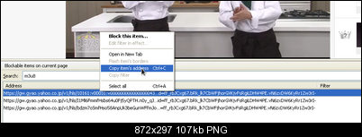

    the site use hls protocol and not rtmp so it's normal that rtmpdumphelper doesn't work
    360p
    rtmpdump -r "rtmpe://fmsf01.yolk.yahoo.co.jp:1935/yolk/1001" -a "yolk/1001" -f "LNX 17,0,0,134" -W "http://i.yimg.jp/images/gyao/player/fla/v1/red/GyaoPlayer.swf?23829049" -p "http://gyao.yahoo.co.jp/player/10161/v00031/v0000000000000000434/" -y "mp4:yolk/109/11/1002/428/2433678_m1avFq6I2428452.f4v" -o "東京乙女レストラン 第4回.f4v"
    480p
    livestreamer "hlsvariant://https://gw.gyao.yahoo.co.jp/v1/hls/10161:v00031:v0000000000000000434/variant.m3u8?device_type=1100&delivery_type=2&min_bandwidth=248&appkey=52hd8q-XnozawaXc727tmojaFD.SD1yc&appid=ff_rbJCxg67.bRk_lk7CbWFjhorGVKjvFsRgiLDHW4PE.vN6zxDW6KyRr1Zw3rI-" best -o "東京乙女レストラン 第4回.ts"

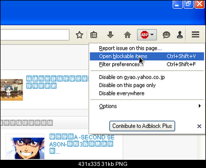

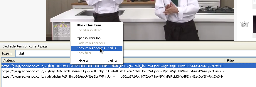

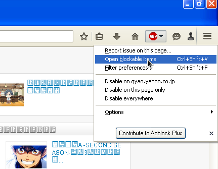

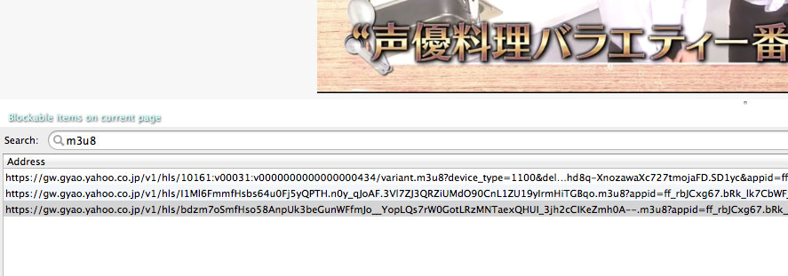

    to find m3u8 url

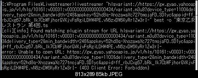

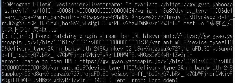

  3. Thanks for such a quick reply. However, being as Windows challenged as I am, I can't get the code you provided to work. I'm not even sure I'm using the programs right.
    I change my directory in the command prompt to the folder where livestreamer.exe is and past the code in. I get this:
    Will livestreamer save the video to my computer?

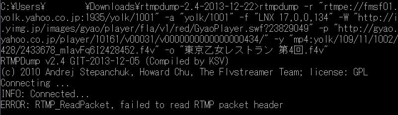

    Same with rtmpdump; I can't get it to work:
    I don't even know what I'm doing wrong and get the feeling it's something obvious. :/
    Also, for future reference can I ask how you got the code for the 480 or 360? In case I run into this type of thing again. I've searched on Google for this type of thing only to get more and more confused.
    EDIT: Just saw the edited post that added how to find the m3u8 url...but what do I do with that...? I have no idea. It took me a long while to get rtmpdump working.

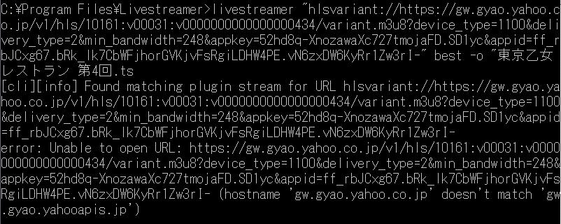

  4. ok for rtmpdump did you use the last version https://github.com/K-S-V/Scripts/releases/download/v2.4/rtmpdump-2.4.zip
    and for livestreamer change host <gw.gyao.yahoo.co.jp> by <gw.gyao.yahooapis.jp>
    livestreamer "hlsvariant://https://gw.gyao.yahooapis.jp/v1/hls/10161:v00031:v0000000000000000434/variant.m3u8?device_type=1100&delivery_type=2&min_bandwidth=248&appkey=52hd8q-XnozawaXc727tmojaFD.SD1yc&appid=ff_rbJCxg67.bRk_lk7CbWFjhorGVKjvFsRgiLDHW4PE.vN6zxDW6KyRr1Zw3rI-" best -o "東京乙女レストラン 第4回.ts"

    Just tried the code for livestreamer and:
    I got the m3u8 url that you told me how to get and tried playing it in vlc and it played for a bit then vlc crashes. I also made sure vlc is up to date.

  6. there a lot of version rtmpdump-2.4
    your version "RTMPDump v2.4 GIT-2013-12-05 (Compiled by KSV)"
    the last version i proposed "RTMPDump v2.4 GIT-2015-01-15 (Compiled by KSV)"

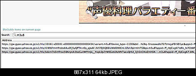

  10. Just thought I'd mention that I seem to have gotten it to work! I thought I'd try one of the other m3u8 urls and it worked. Thank you for telling me how to find those urls. I had no idea before.
