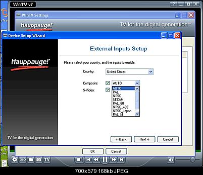

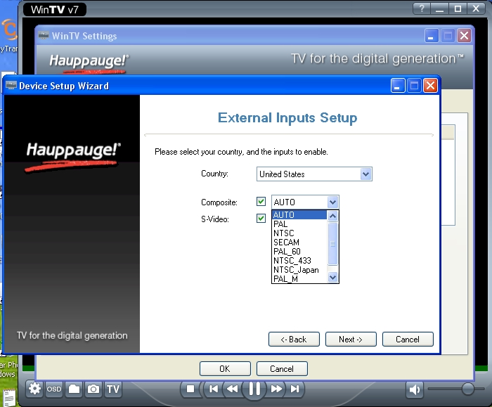

    The only software I have found that can switch between PAL60 and NTSC433 in a reliable way is WinTV7.....and you will require an added file (available free from the WinTV website). This option works with my Hauppauge USB|Live2 device. What you are trying to do is not usually included in the "specification" of any capture device/software unfortunately.

    It's also not as easy as choosing PAL60 either in WinTV. You need to go through the wizard and install a new PAL60 tuner. Good thing it's easy to delete and install tuners in WinTV.....once you know that you need to do that. No need to run a channel scan either, S-Video and Composite are the channels.
