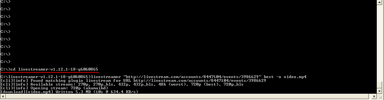

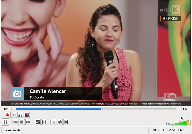

  3. @ MaahLuz
    I'm not sure if i understand everything what you want
    but livestreamer works to download this stream
    livestreamer "http://livestream.com/accounts/8447104/events/3986629" best -o video.mp4
    [cli][info] Found matching plugin livestream for URL http://livestream.com/accounts/8447104/events/3986629
    [cli][info] Available streams: 270p, 270p_hls, 432p, 432p_hls, 48k (worst), 720p (best), 720p_hls
    [cli][info] Opening stream: 720p (akamaihd)
    [download][video.mp4] Written 11.9 MB (33s @ 275.8 KB/s)

  8. Originally Posted by MaahLuz View Post
    @bizeom i couldnt get it what version are you using? i tried with 1.12.0 but i got the same error (error: No streams found on this URL: http://livestream.com/accounts/8447104/events/3986629) then i downloaded the 1.12.1 and i cant make it work, i thought i got the error because of the version but i'm not sure about it.
    hi the last Nightly build
    the last development version
    http://livestreamer-builds.s3.amazonaws.com/livestreamer-latest-win32.zip
    but you need use this version in static mode
    go in the folder in my exemple C:\livestreamer-v1.12.1-18-g6060865

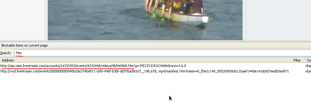

    you want the videos?
    first video
    livestreamer "hds://http://api.new.livestream.com/accounts/14330353/events/4242446/videos/96546968.f4m" best -o video1.flv
  22. Originally Posted by biezom View Post
    first video
    Daaaamn, how do you get this info? I read a bunch of posts I would have never guessed to use this syntax... I guess I can use the same format for all the videos, just replace the video number.
    Thank you, well done. Would like to understand what I look for (I found the api.new... inside the "show source" but didn't know how to use it).
    Cheer mate!
  23. Originally Posted by teredactle View Post
    Cheer mate!
    tools: firefox; adblockplus addon
