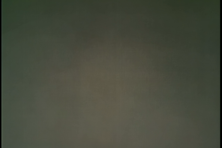

    My source captures don't have banding. Here, I mixed all the frames of this one 45-minute episode into one frame using Overlay. Notice that even this gets banding:
Name:	NA1 average avisynth.bmp
