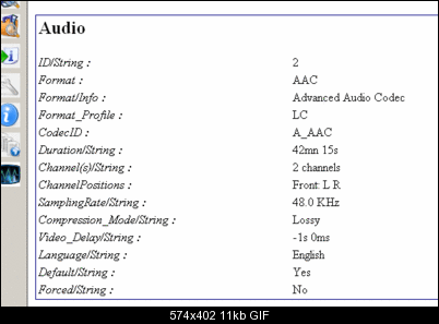

    It seems like it might be a player issue. I just tried setting a video delay using MKVToolnix 7.6.0 and 7.8.0 and each time it worked fine. You can check if the delay is being set correctly using MediaInfo. You can't have negative delays for tracks in MKVs, but MediaInfo displays a negative audio delay instead of a positive video delay, so you can check for that.
    A one second positive video delay looks like this to MediaInfo, but don't forget if the audio also has a delay they can effectively cancel each other out.

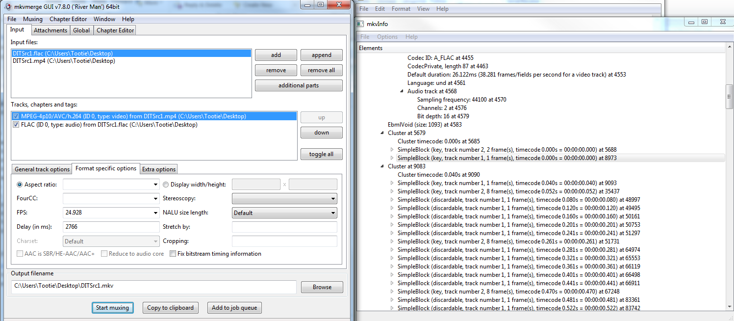

    The delay is the result of a desire to intentionally modify the beginning of a video. When direct-stream remuxing you are limited to cutting in with I-frames. In this case, a black frame is available as an I-frame, which could be repeated during the onset as desired, but then I would have a lot of math to re-do in order to maintain sync because I'd have to factor in a modified frame rate, and as I've previously stated I'm not sure what is what in that regard.
    Here's a screencap of what I'm doing and the info MKVinfo shows me that the video stream is not being delayed as intended.

  10. It seems to be a bug in MKVMergeGUI. Unless it intentionally works this way, but I doubt it as the command line includes the specified video delay. It won't change the frame rate and set the video delay at the same time. At least not when it's a positive video delay. It seems to work okay when the video delay is negative. I've tested versions 7.6.0 and 7.8.0 so it may be a bug that's been around for a while. The only way to do it at the moment seems to be to mux the video/audio twice. Once to change the frame rate and then by opening the MKV with the new frame rate and setting the video delay.
