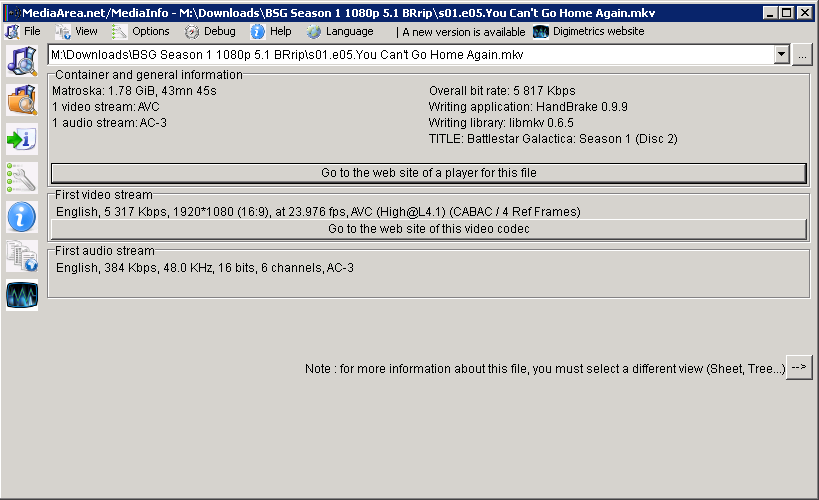

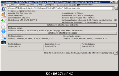

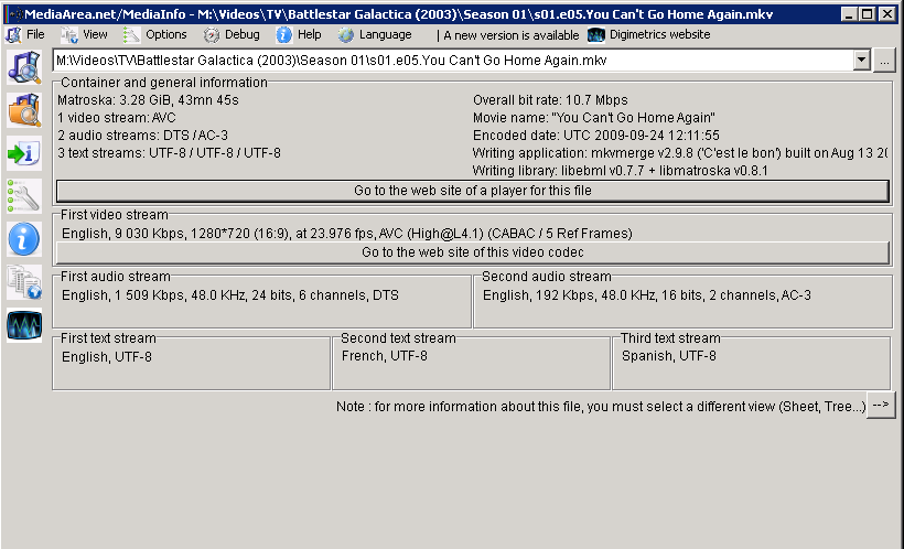

    I have 2 videos of the same episode of a show, one is 1080p and the other is 720p. The obvious answer is the 1080p copy is better, but I was looking at them with MetaInfo and I am not sure, looking for help from someone who is in the know.
    The 1080 copies bit rate is 5,817 Kbps, but the 720 copies is 10.7 Mbps. Is that going to make a noticeable difference? It is double.
    Also the audio on the 1080 copy is 384 Kbps at 16 bits vs the 720 copy is 1,509 Kbps 24 bits.
    I am thinking the 720p copy is better here, am I wrong?
    Thanks for any help.

    Sorry, screens of MetaInfo
    ATTACH]31239[/ATTACH]Click image for larger version

    I am streaming with Plex to a Roku and a 1080p TV.
    I put the same episode one at 720 one at 1080 and honestly I could not tell the difference. In that case I think I will go with the 1080p, since the size is smaller and it matches the resolution of my TV.
