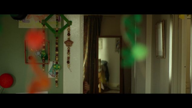

  9. The video in question needs horizontal bars top and bottom. There's 62 pixels worth on top and 62 on bottom that VidCoder is removing (according to the pic in post #5), and the output aspect ratio of the video itself is 2.40:1 (853/356). Your TV screen is 1.7777 (16:9). The only way for a 2.40:1 picture to display correctly on a 16:9 screen without stretching or zooming (and your TV might have a zoom but if it does I'd disable it for testing until you know what's working correctly) is to have black bars top and bottom (they're cropped/removed when encoding, but the player should add them back on playback so the shape of the actual picture remains the same).
    A 2.40:1 video on a 16:9 screen should look something like this:
    AutoGK confirms this. It crops the black bars and then resizes your video to square pixels (that's how it resizes), so the resolution and aspect ratio are the same. It resized to 720x304 and 720/304 = 2.37:1. AutoGK probably cropped a little differently to Vidcoder so as not to distort the picture when resizing which is why it's not exactly 2.40:1 but don't worry about that for now. DVDs don't use square pixels so the aspect ratio and resolution are different but don't worry about that for now either.
    So if the AutoGK encode displays without black bars top and bottom it's displaying incorrectly. I don't connect my TV over a network but while the TVs are displaying the video in question try pressing the Tools button on the remote and if there's a picture size option you probably want "mode 1". Mode 2 will stretch the picture to fill the screen (evil unless the picture is supposed to be 16:9).
    If you encode the DVD used in your pic in post #5 with Vidcoder, try changing the anamorphic option to "anamorphic none" (the video will be resized to square pixels just like AutoGK does it) and change the resizing to around 854x356 if need be. That'll be the about the same aspect ratio as AutoGK, but with a higher resolution, however both should display the same way (black bars top and bottom).
    720x304 = 2.37:1
    854x356 = 2.39:1
    When they display correctly with black bars top and bottom, by adjusting whatever TV/player settings need to be adjusted, then you can move onto using anamorphic encoding with Vidcoder and discover the joy of anamorphic video probably not displaying correctly, but from the information you've posted so far it appears when you think the video is displaying correctly it's not, and when you think it isn't, it is. I think......

  11. Originally Posted by hello_hello View Post
    Knowing that most if not all TVs these days are 16:9, why is the DVD source footage in such a wide aspect ratio? What confuses me is that HB indicates that the source is really 720x480 when I open the source DVD folder. I need to a little lesson in aspect ratios, why there are many types, and how a playback device knows how to take a 720x480 source and play it in the aspect ratio it was intended to be displayed on.
    If AGK does this automatically, why doesn't HB?
    But what doesn't add up to my is why can my newer TVs can play the MP4 file created by HB in the correct aspect ratio but my older TV (which only has the choice of receiving the video stream via DLNA) displays an incorrect aspect ratio. How do the newer TVs know to display it correctly?
  12. Originally Posted by njitgrad View Post
    All NTSC DVDs are 720x480. They're either squished to 4:3 on playback or stretched to 16:9 (1.777777), depending on whether they're a 4:3 or 16:9 DVD. The aspect ratio is stored in the video stream (for the purpose of the discussion).
    If they're 16:9 and the picture has a wider aspect ratio than 16:9, it's encoded with black bars top and bottom, however it's still 720x480 and 16:9, but that's including the black bars.
    If the black bars are removed when you encode the resolution is no longer 720x480. If there was 62 pixels worth of black at the top and 62 at the bottom, what you're left with is 720x356.
    Remember for a 16:9 DVD the picture is stretched to 16:9, so if you translate that to square pixel dimensions the 720x480 DVD is stretched to 852x480 on playback to display correctly. 852/480 = 1.777777 (not quite, but for the purpose of the discussion I'll stick to whole numbers for the resolution).
    Your cropped DVD would be stretched the same way, but you've removed the black bars top and bottom and the height remaining is only 356, so it's not 852x480, it's 852x356, and 852/356 = 2.40:1.
    After you've cropped the black bars you can encode it two ways. You can encode it at 720x356, but for it to display correctly the player needs to stretch it to 852x356, add back the black bars for 852x480 (16:9), then upscale it to fill the screen (effectively), but for the 2.40:1 video to display correctly, it still needs the black bars top and bottom so the total resolution is 16:9 again, assuming you have a 16:9 TV. Encoding at 720x356 and stretching to 852x356 on playback is called anamorphic encoding. The aspect ratio is written to the video stream.
    The alternative is not to use anamorphic encoding. You resize to square pixels first, then encode. These days you'd probably resize to 852x356 after the black bars are removed and encode. When AutoGK ruled the world, the maximum width was generally 720 pixels, so instead of stretching the width and resizing to 852x356, it'd reduce the height and resize to 720x304 or thereabouts after removing the black bars. The same principle applies though. 852x356 and 720x304 aren't 16:9 so the black bars need to be added back on playback for a total aspect ratio of 16:9 if you have a 16:9 TV.
    Not all 16:9 DVDs have black bars top and bottom. Some use the whole 720x480 for picture, so the picture is 16:9, they'd be encoded using anamorphic encoding at 720x480, or resized to square pixels by Vidcoder first for 852x480 and then encoded, or resized by AutoGK to 720x400 etc. Whichever way, the picture is 16:9 (or very close).
