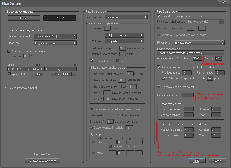

I've experimented a bit with Deshaker, and was able to get some improvements, although not 100%. As others have mentioned, Deshaker doesn't really provide "rock stable" results. But it seemed not to mess with the video quality which I thought was a good thing and my primary concern in this case.

Avisynth is the best option if you want to preserve the color space as NLE, etc convert to float-point RGB and back to YUV. Either way I'm unsure how you want to keep the original untouched, in any case a (lossy) encode is typically involved.
With any filtering there's always a degree of degradation, the point is whether it's worthy and in this case the nervous letters tell me it is. The only rock stable filter for avisynth is stab() (and derived). There's also stabilise() but that one never was anything more than experimental.
Deshaker is stabilization of the "global motion" type so it doesn't work (at all) for this case. I passed it through stab2() so you can check how it compares. Probably professional solutions (Mercalli, or the ones named above) can do some better, but at the cost of manual set up by scenes.

BTW, one thing I mentioned in my Deshaker guide, but is worth mentioning in this thread. This is somewhat unique to Deshaker, but may be true of Stab pac and other algorithms.
Here it is: Deshaker does not alter the first and last frame of the clip.
So what? Well, that means that you can cut up a scene into several clips, and apply stabilization to only some of those "sub-clips," but leave the others alone.
What good is this?
Well, a lot has been made of the fact that most stabilization fails -- and fails badly -- under some circumstances. This has certainly been my experience. When these failures happen, the result is actually worse (IMHO) than the original. My solution, when stabilization fails, is to note which portions of the clip are bad, and then re-do the stabilization, but don't apply stabilization to the bad sections: I only stabilize the portions immediately before and after the "bad" section. Then, because of what I just mentioned (that the beginning and ending frames of the stabilized clips are not altered at all), the stabilized version joins up perfectly with the unstabilized version.
This obviously won't work with any stabilization tool or algorithm that crops or zooms to deal with the border issue.
This may not be useful for some of the work being discussed here, but I thought it was worth mentioning for those who are trying to do work with the tools we have at our disposal, but don't want to completely give up on problem clips. -
