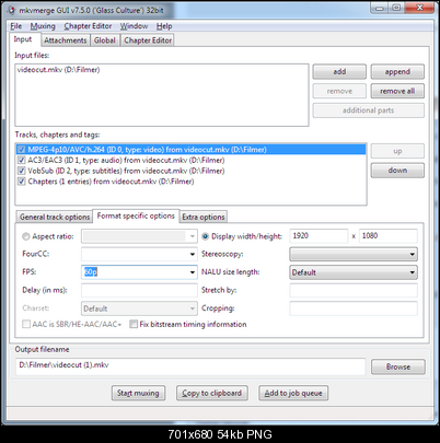

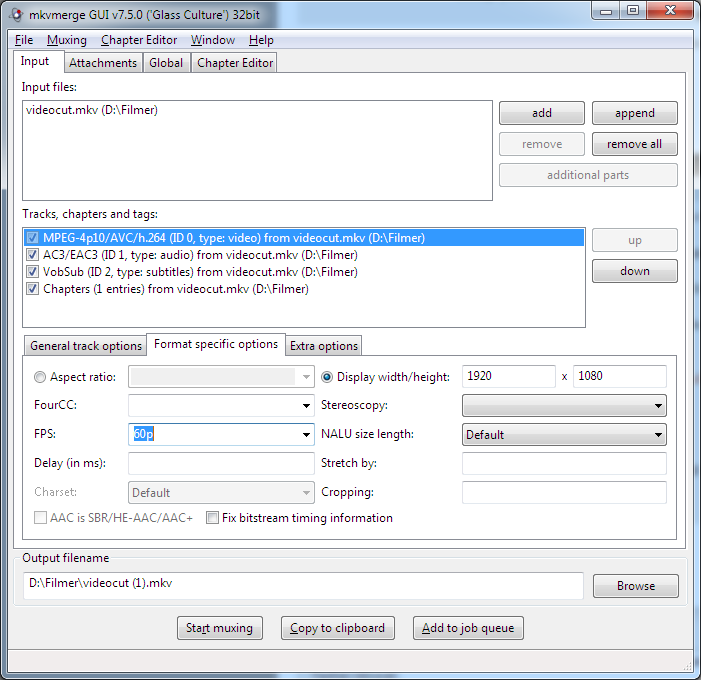

    You can change the fps with mkvmergegui, open the mkv, select the video track, change the fps under format specific options. Start muxing. And it will play faster/slower.

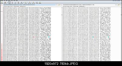

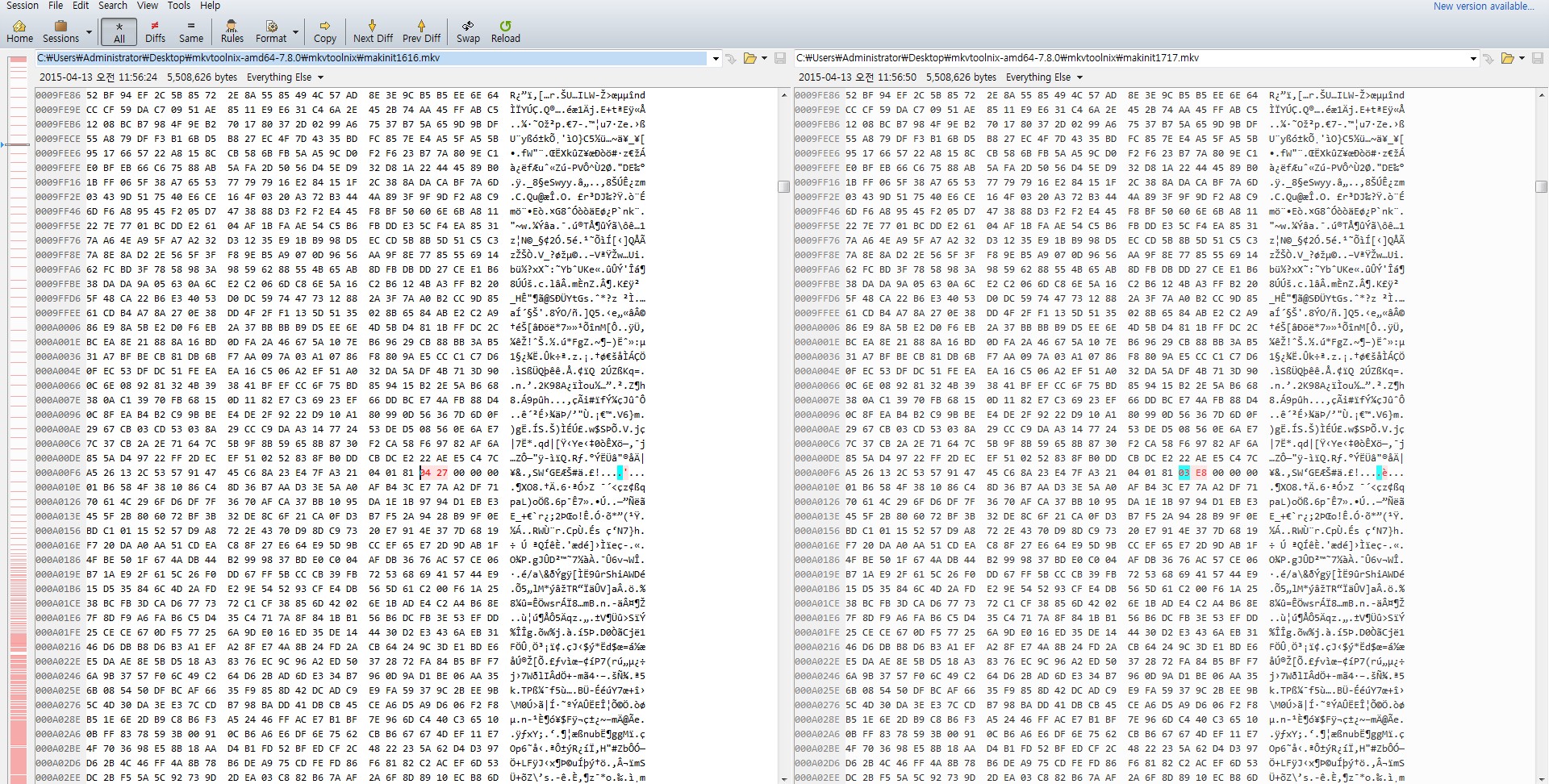

  3. Of course I tried with mkvmerge, and found input.mkv and output.mkv were globally different in hex editor.
    You might think mkvmerge replaced only a few bytes, but it is NOT.
  4. Click image for larger version
Name:	different in middle.jpg
    As you see, there are many different spots even in the middle of two files.
    Note that there are abundant different spots especially in the end of file contents.
