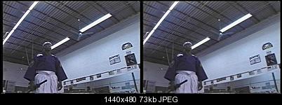

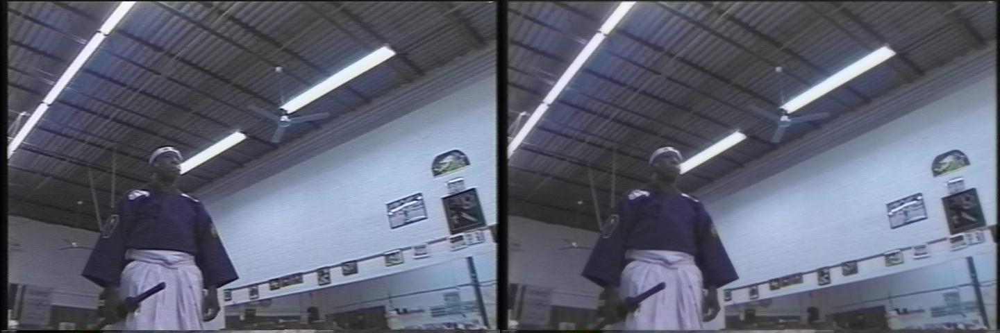

  2. You mean the halos at high contrast edges? Those are from over sharpening by the VHS deck. And maybe from your capture device too. If your VHS deck has a sharpness control turn it down. The same goes for your capture device. You can alleviate it with a dehalo filter like dehalo_alpha() in AviSynth.
    AviSource("ijs.avi")
    ConvertToYV12(interlaced=true) # dehalo_alpha requires YV12
    Separatefields()
    Dehalo_alpha(rx=4, ry=2)
    Weave()
    original on left, dehalo on the right:

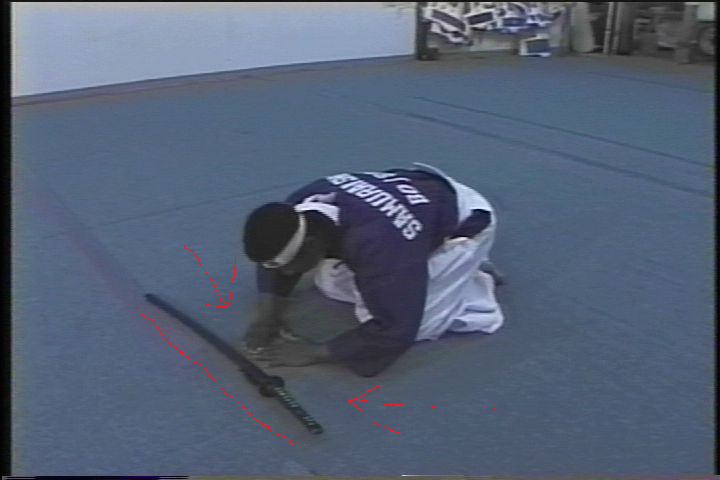

    Thanks, does this also result the brown glow around the sword and by the mans arms where the arrows are pointed is also a result of sharpening?
Name:	vlcsnap-2015-04-12-11h02m33s116 - Copy.png
    Chroma is offset +
    the chroma is smeared (even when offset is fixed, it will bleed over).
    Fix offset in Avisynth.
    Use VirtualDub CCD to fix the rest.

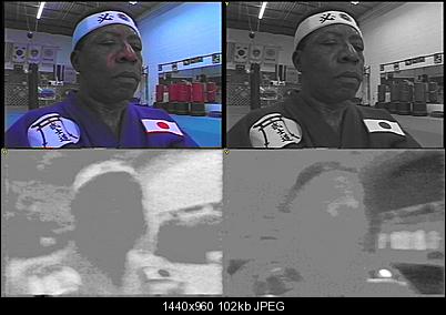

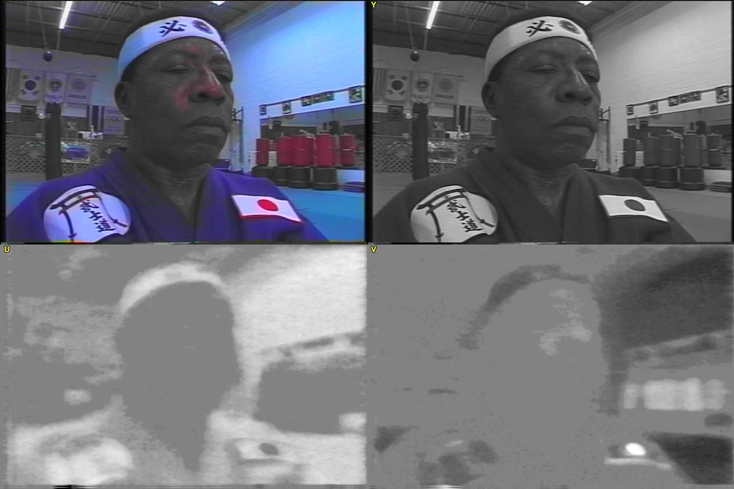

  7. You can see how much to shift the colors by looking at the video. Here's the source video with a big saturation increase (to see the colors better) and the luma channel to the right, then the U and V channels (stretched to the same size as the luma) below:

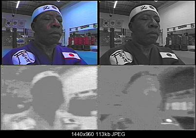

    After sharpening the chroma and shifting up by 4 pixels, right by two pixels:
    MergeChroma(aWarpSharp(depth=20))
    ChromaShift(l=-4,c=2)
    See how the colors align better on the flag and the barrels. The chroma channels in VHS are very low resolution horizontally. About 40 lines across the entire frame.
