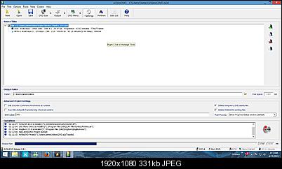

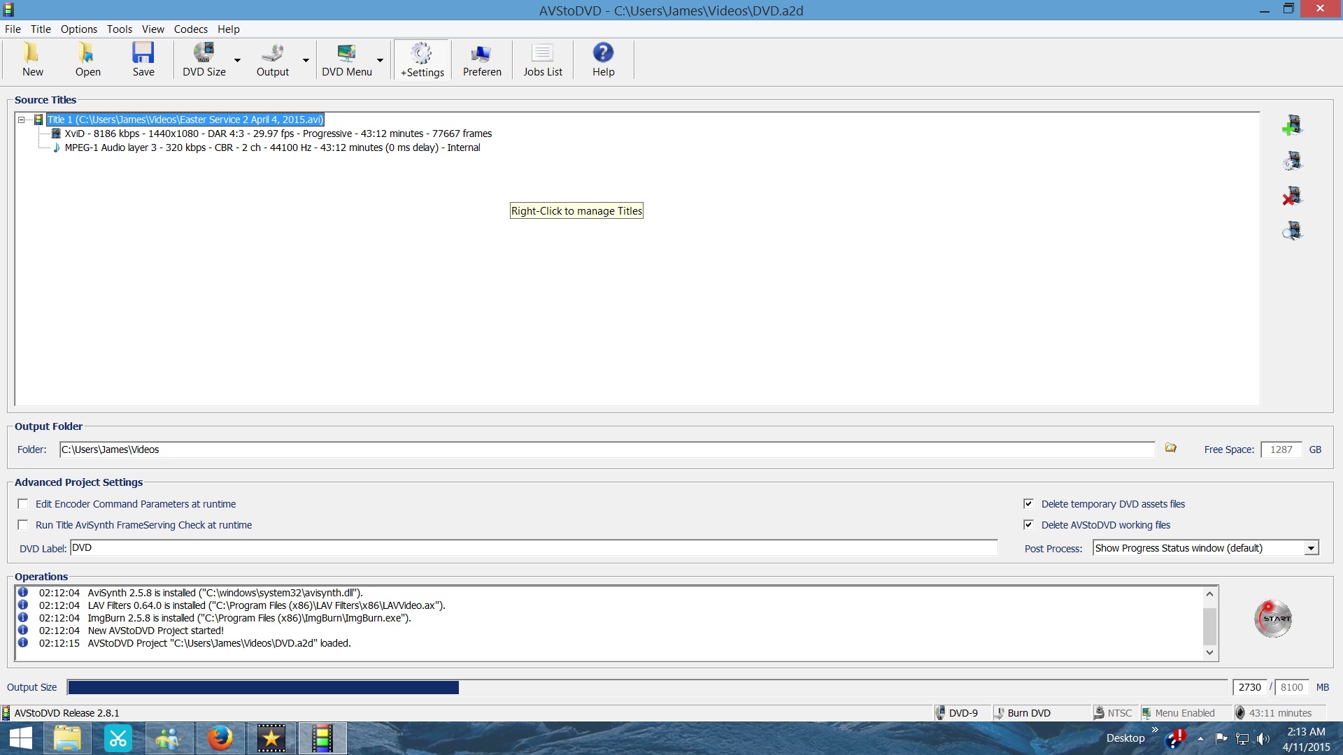

    Plays whitewashed AFTER I burn it to DVD and watch the DVD on my PC. It plays perfect on the PC BEFORE being burned. So I feel that some setting has got to be off.
