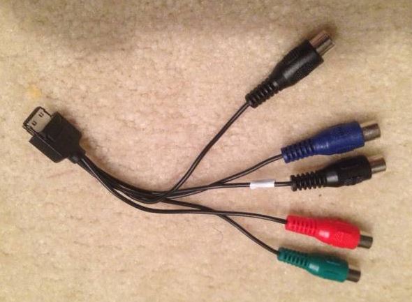

    The HD-PVR 2 has an AV port which accepts one of two AV breakout cables for component video and stereo audio input. It should have been included in the box.
    The one you need depends on the HD-PVR 2's model number, but it is easy to tell them apart. One is for a round connection, and the other is for a relatively flat, rectangular connection.

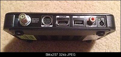

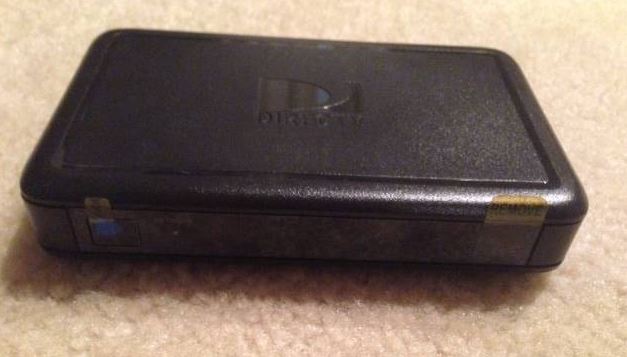

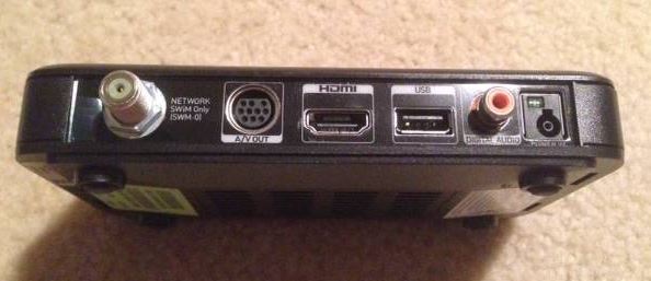

    Hi All,
    Well, not having much luck so far.

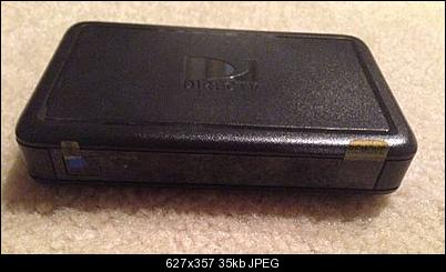

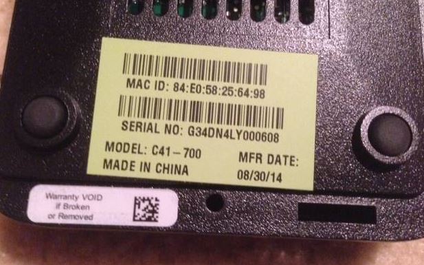

    Below is the DTV Genie box I'd like to use.

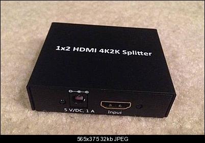

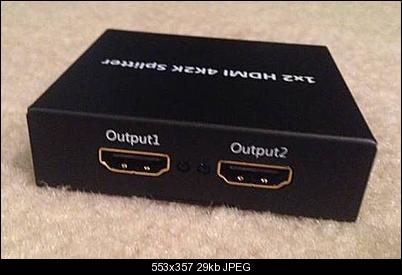

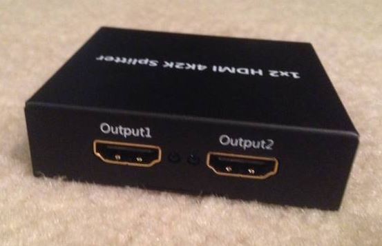

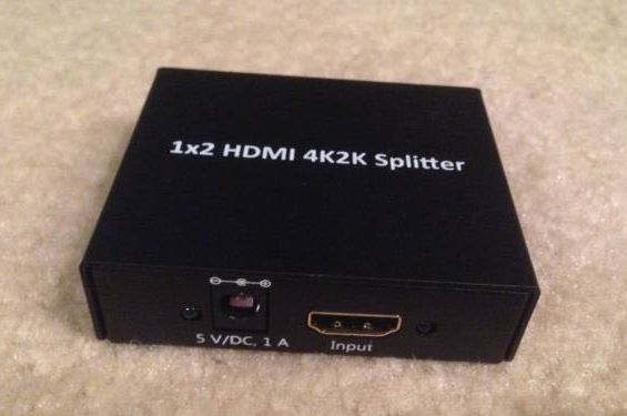

    See below the HDMI Splitter I bought at Fry's Electronics.

    Maybe this splitter doesn't work, who knows. Everytime I go to capture, the screen turns black.
    My next try is to return this one, and buy the ViewHD splitter.
    I had no problems capturing from a Comcast box last year, when I had Comcast, but I'm guessing the box was not HDCP enabled.
  5. Not every HDMI splitter removes HDCP. In fact, very few do -- it's a violation of the HDMI license and is illegal in many places. You need to buy one of the splitters known to remove HDCP.

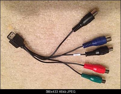

    Below is the rectangular connection I have that you mentioned, if I concede and go the component route. not ready to do that yet.
    jagabo, I understand, looks like the one I bought doesn't remove it. I will buy the ViewHD one and see if it works.

    The splitter you already bought looks to be the same hardware as a different ViewHD Splitter, the "ViewHD Ultra HD | 4K HDMI 1x2 Mini Splitter (Model: VHD-Pluto)", which does not remove HDCP as a side effect. Make sure you do not mistakenly buy the "ViewHD Ultra HD | 4K HDMI 1x2 Mini Splitter (Model: VHD-Pluto)" from Amazon as well. Buy the "ViewHD 2 Port 1x2 Powered HDMI Mini Splitter for 1080P & 3D". Use the link in my other post to find it.

    Just bought the "ViewHD 2 Port 1x2 Powered HDMI Mini Splitter for 1080P & 3D", from Amazon. Hopefully this will work.
    If they haven't changed the components from when I bought one about 9 months ago, it should still work.
    Originally Posted by JBIIRockets View Post
    All you do is plug an hdmi cable from the dtv box to the input of the splitter, then plug an hdmi cable from 1 of the outputs to the input of the HD PVR 2, then use a third hmdi cable to go from the hd dvr 2 output to an input of my tv, right?
    Yes.
    Will it work with HDMI cables listed as "latest standard/version" such as these?
    https://www.amazon.com/Twisted-Veins-cables-Adapter-Velcro/dp/B014EV0G3G/ref=sr_1_5?ie...ds=hdmi+cables
    As it happens, I bought those same cables to use with my splitter and they worked.
