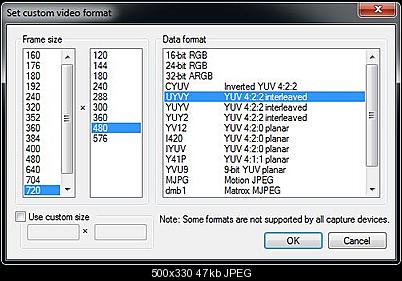

  1. I have a raw captured file, and I noticed the values never go above 100 and below 0. Arcsoft Showbiz didn't clip the values. How do I tell VirtualDub not to do this?
  2. 0 and 100 what? 8 bit luma values? IRE? Did you capture RGB? YUY2?
  3. IRE.
    That is what I selected.
    What is the best option?
  4. With those settings Virtualdub will capture values below Y=16 (IRE 0) and values above Y=235 (IRE 100). If you're not getting values outside that range it's because your source is putting them out, or your capture device is crushing them.

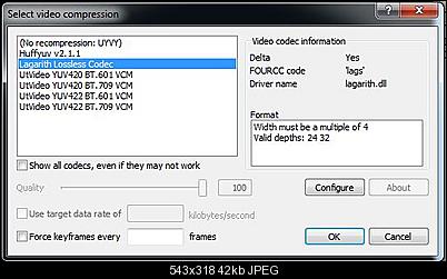

  8. VirtualDub is avi Lagarith
    ArcSoft Showbiz is MPEG-2, then I convert it to MPEG-4 via Handbrake because Premiere will not import MPEG-2.
    I brought them both into the timeline and used the YC waveform. The slight vertical black bars are below 0 with Showbiz, and VirtualDub stop at 0.
  9. Premiere treats lagarith as RGB (even in YUV mode , either YV12 or YUY2), so it will clip values. Try UT Video Codec

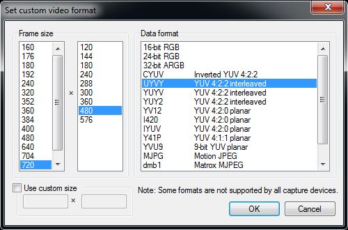

  11. Click image for larger version
    Which one should I use?

  14. For SD captures - YUV422, 601
  15. SD captures - YUV422, 601
    I just tried capturing with this. The luma values are still clipped to 0 and 100 IRE.

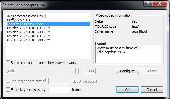

  18. If if you want something that works 100% on every configuration, every version, you can uncompressed UYVY for 8bit 422, but large filesizes. v210 also works (10bit 422)
    That worked, but the file size is too large. What other lossless compressors should I try?
  19. Originally Posted by Hypersonic1 View Post
    I don't know why it works for some people and not others. People have tried debugging this - OS, version, updates, swapping AVI importer version, codec version, etc.... and can't make any sense of it .
    You can try magicyuv, huffyuv (there are a dozen different variants) - but likely they will all be treated as RGB with your current configuration if UT was
  20. As for the MPEG-2 issue, it will import in CC but not CS6. It has audio sync problems when brought into CC, but not when played in VLC. I would rather just stick with VirtualDub anyway. I just need to find the right codec.
  21. You can try magicyuv, huffyuv (there are a dozen different variants) - but likely they will all be treated as RGB with your current configuration if UT was
    It's clipped with this too. What should I do now?
