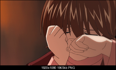

  1. I noticed when I went to clean my Blu-Ray up if you look along most of the black lines, it looks there's gray/black color bleeding in the shape of a staircase or something over the lines.
    Here are a few screenshots to show what I am talking about.
    https://forum.videohelp.com/images/imgfiles/jlpfhPh.png
    https://forum.videohelp.com/images/imgfiles/NiRUqBH.png
    https://forum.videohelp.com/images/imgfiles/1nE6UpS.png
    What can I do to get rid of this?
  2. It looks to me like the filter that converts YUV 4:2:0 to RGB 4:4:4 is duplicating chroma samples rather than interpolating them. Your source has a 1920x1080 luma channel but the colors are encoded at 960x540. When converting to RGB the 960x540 colors are upscaled with a nearest neighbor filter. Try using different software.

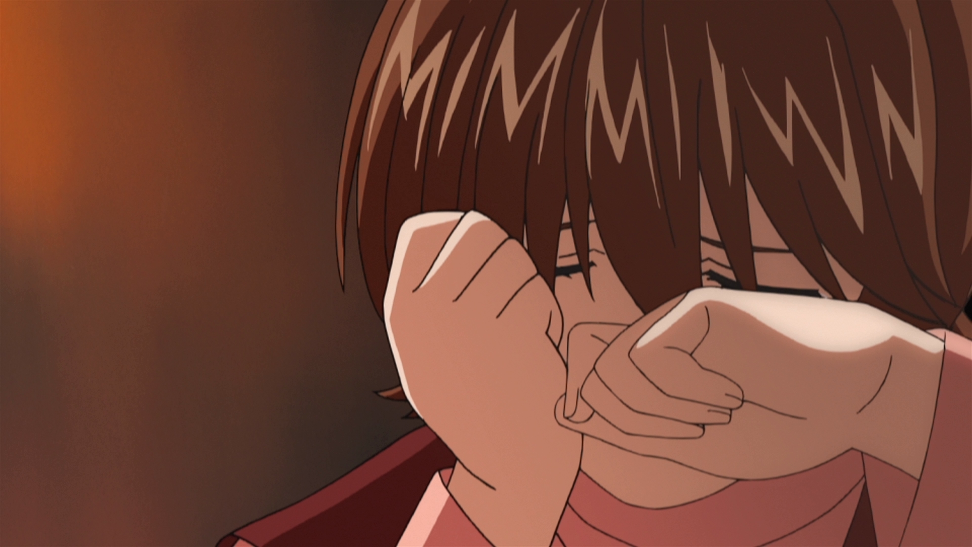

    You can clean it up a bit in AviSynth with a sequence like:
    MergeChroma(BicubicResize(width/2,height/2).BicubicResize(width,height).aWarpSharp(depth=10 ))

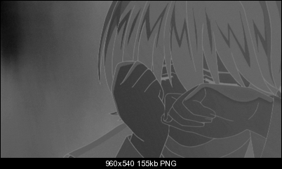

  7. Originally Posted by killerteengohan View Post
    It does this on both my Blu-Ray Players and PS3 as well, so its not just my computer media players having the issue.

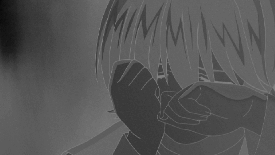

    So it's more than just a decoding problem. If you look at the chroma channels you'll see they're badly aliased. Here the U channel (the V channel has the same problem) with a big contrast stretch (to make the problem more visible):
    That's a pretty bad screw-up.
  8. I'm heading off to bed. I'll check it out tomorrow.
  9. Alrighty, goodnight and thanks. I will check back tomorrow.
  10. The problem is definitely in the source, not your processing. The chroma channels are like the image I posted last night. It's as if they removed every other column and resized what was left, leaving terrible aliasing artifacts. I don't see any good fix other than something like what I posted earlier.
